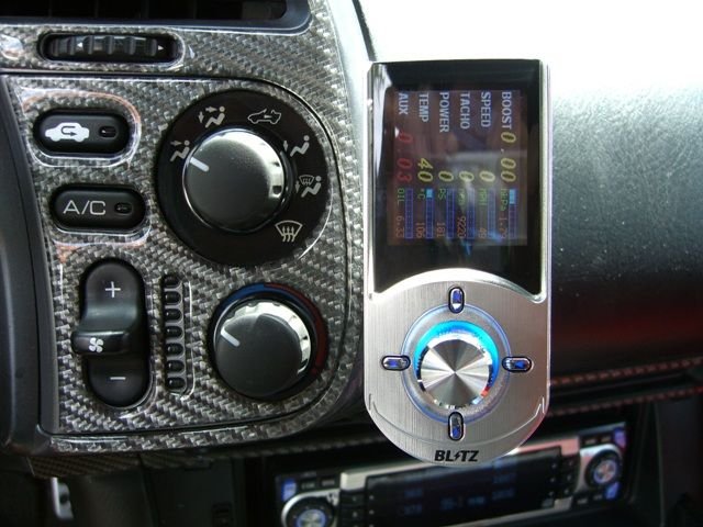

Hey guys, im having trouble getting the speed to display on the Blitz unit. RPM, oil temp, oil pressure, and boost all work fine. Are we missing something?
I found this doing a search.
"The ECM has a terminal A9 which is called "Vehicle Speed Input (VSS)" it goes to the Vehicle Speed Sensor via a Blue/White wire (also goes to the Gauge Assembly with a Blue/White wire).
The Speed Sensor is mounted on the Transmission on the left side. It has a 3 wire connector with Black (ground), Blue/White (Sensor output to the ECM) and Yellow/Blue (Reference Voltage)"
My mech double checked, and he said it is connected to the "blue/white" wire. Any help/input would be greatly appreciated! Thxs
