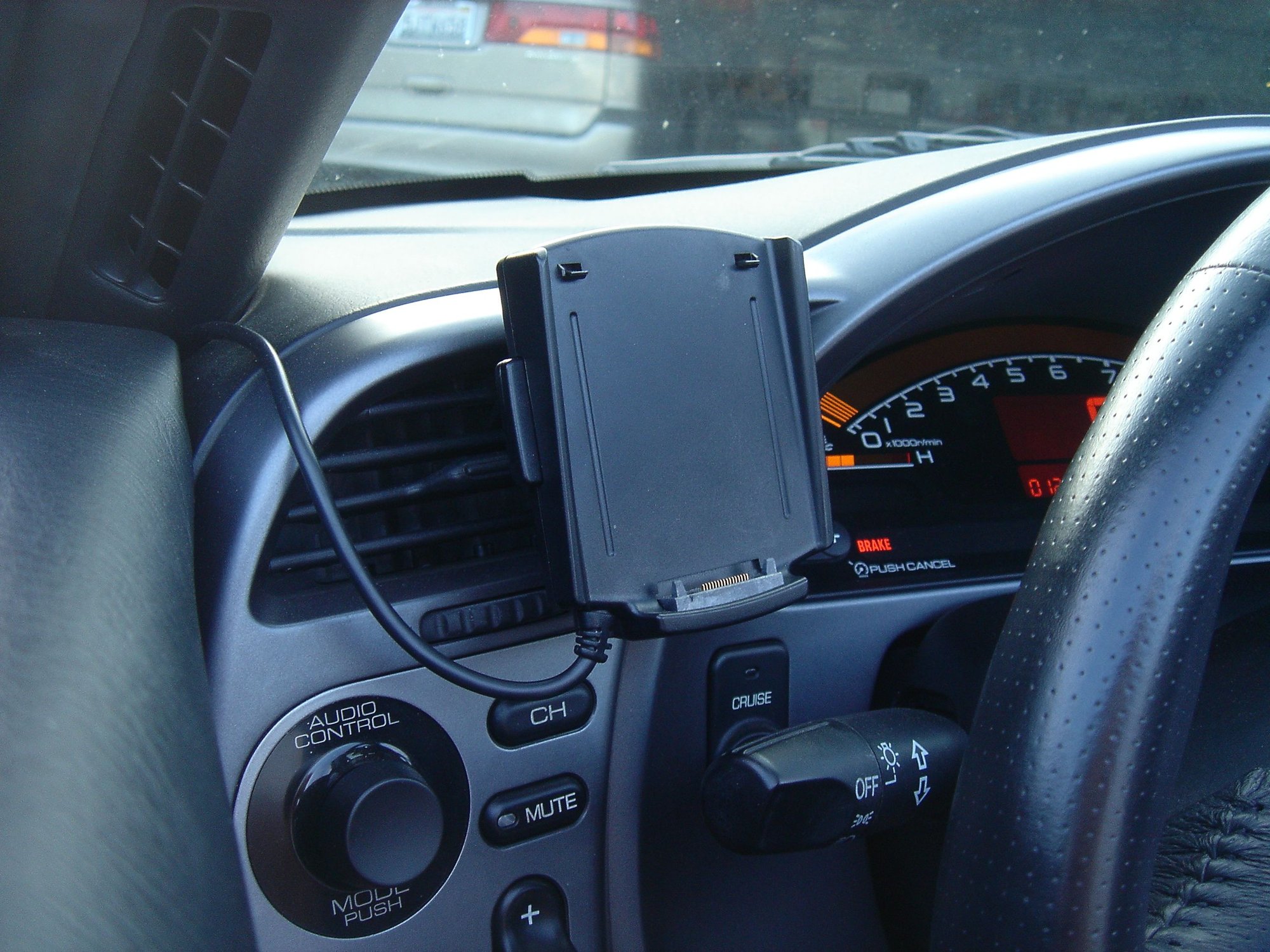

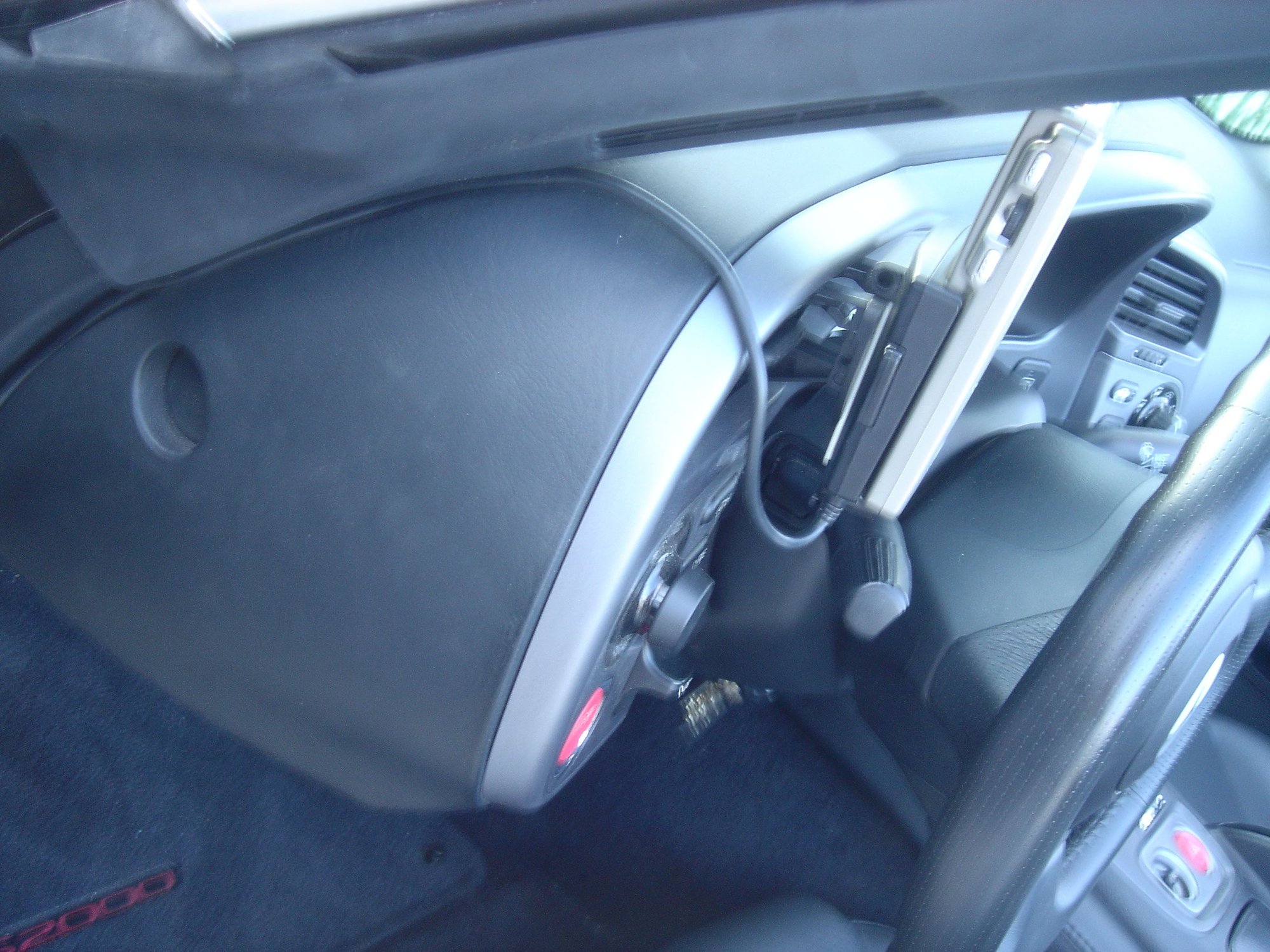

I just got a Palm Tungsten E2 and TomTom combo and am looking to hardwiring at least the Tungsten portion. I was wondering if anyone had done this before and how? I mean if it's even possible. I've done the searches and have seen the hardwiring of the radar detectors and other things, but not a palm, yet.
I was thinking I could buy another home recharge power wire, cut it, and somehow hardwire it to the car, which would be cleaner since I won't have the cig lighter charger running thru my car. I already know how to run the wires, I just need to know if it can be done and how. I know the plugs for the palm and tomtom bluetooth receiver are unique but if I could hardwire them both, that would be sweet.
Hopefully some of you electrictronic gurus can answer my question.

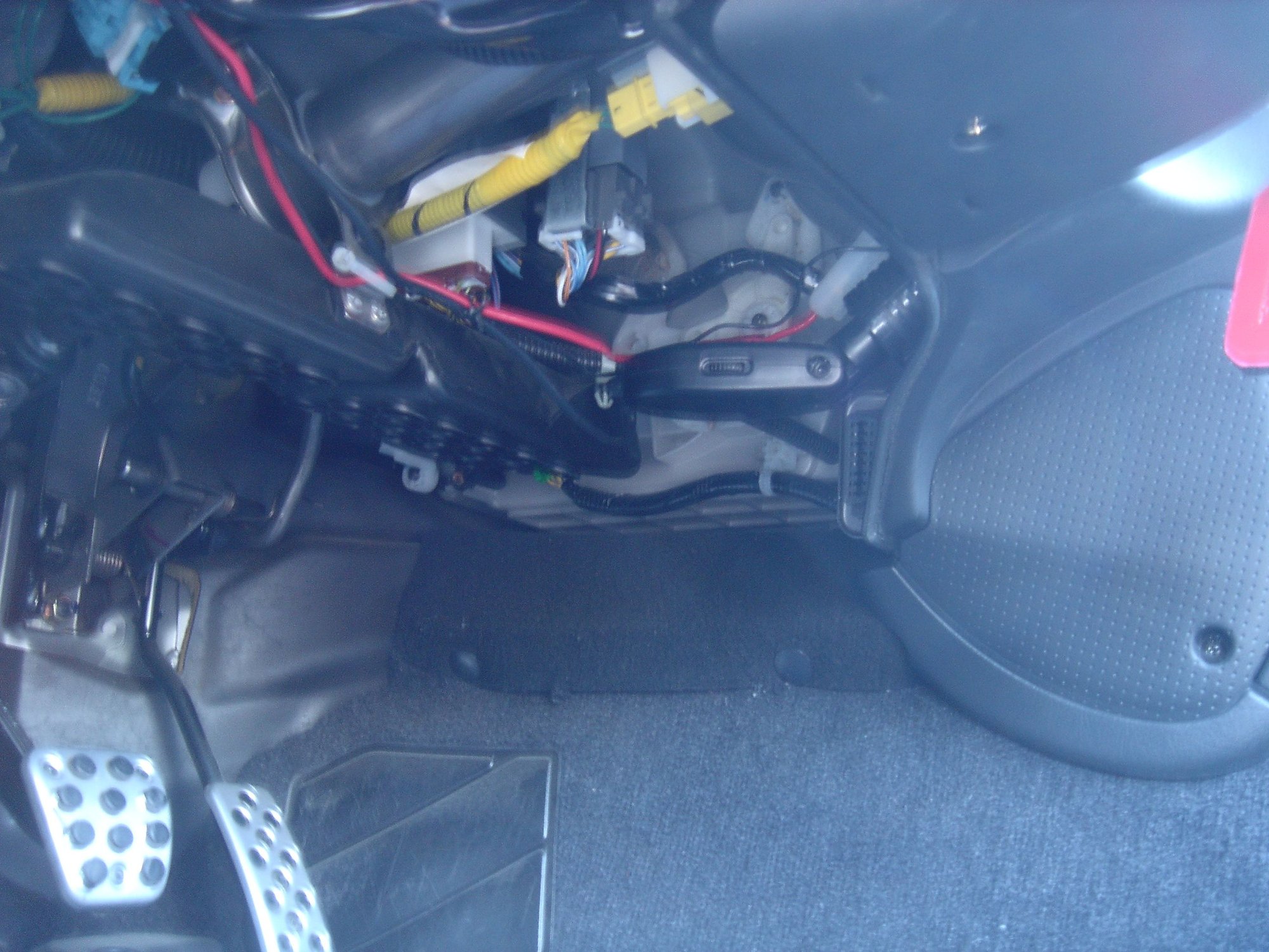

For my Garmen, i didn't want to cut the power cord in case i ever wanted to use it in my other vehicle, so i just got a female power socket from radio shack and wired that up. Plugged the garmen into it and hid the whole assembly behind the dash.

I did this too. I added an accessory power socket under the dasy and routed the car cit for my garmin under there. Not a big fan of cutting wires.

This extra female socket approach is really a better solution than a direct hardwire, for two reasons:
First, it's more flexible -- you can put a couple of sockets on there or switch out gadgets on the one (assuming they're all low-amp trickle chargers).
Second, some 12-V adaptors for these gadgets have electronics in the plug end to do the 12V -> whatever conversion. Cut these off and do a direct wire, and you'll fry the gadget. HPH
