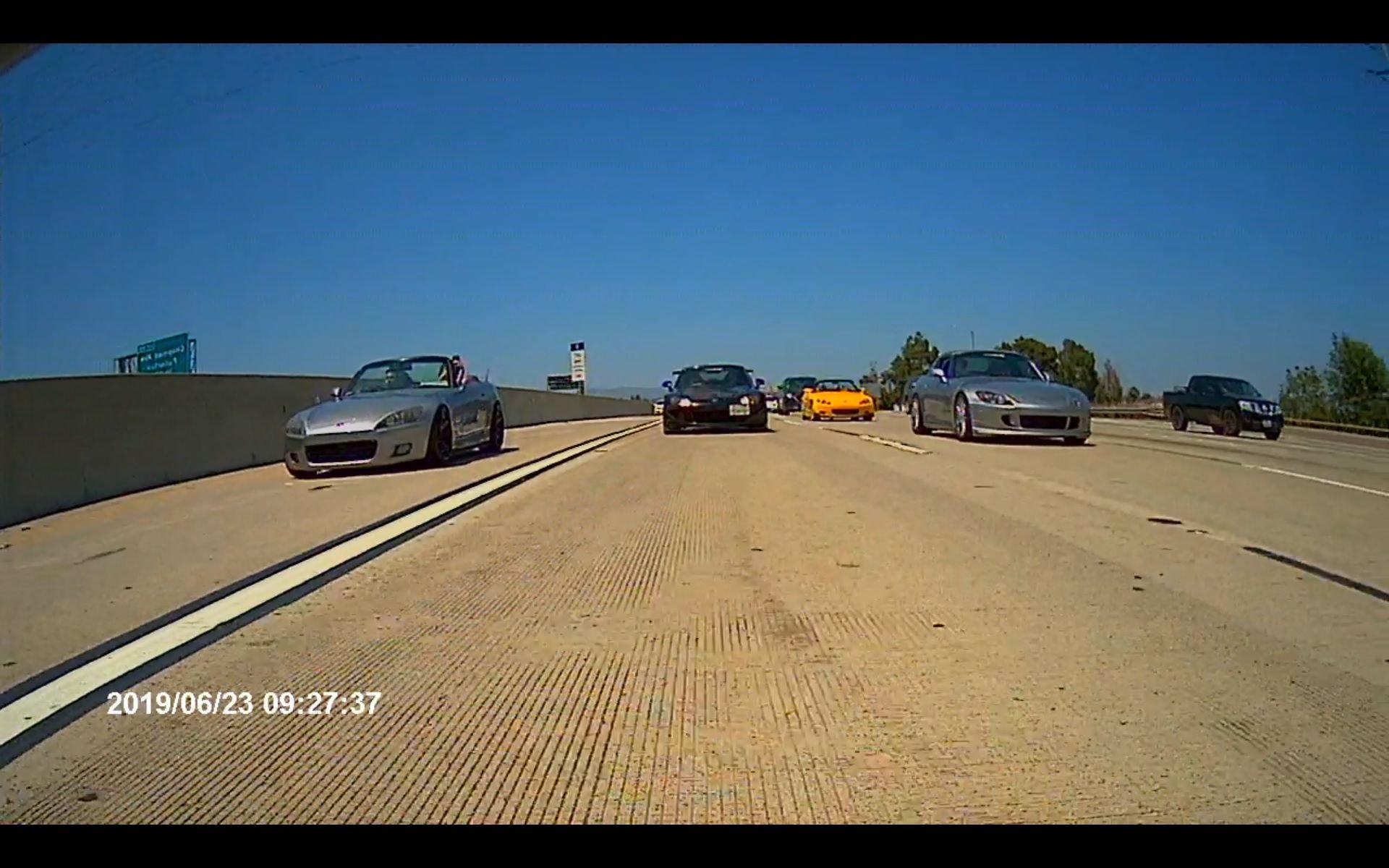

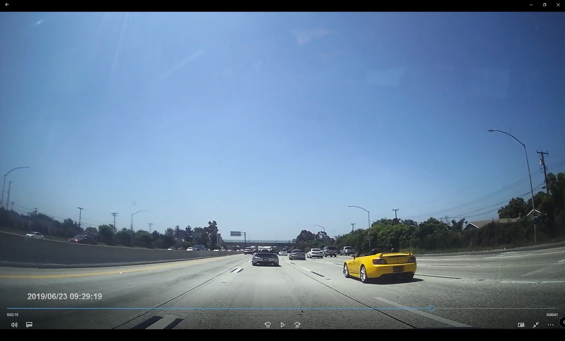

Here is a dash cam installed on my S2000, 3M double stuck to my rear view mirror. I tapped power from behind the cigarette power source, and ran the rear camera cable through the license plate light grommet. It records about 1 hour of videos recording both front and rear segmented in 3 minute intervals. Pressing the lock options prevents over write of existing recordings.
https://www.amazon.com/gp/product/B07N74K2RC/ref=ppx_yo_dt_b_asin_title_o05_s00?ie=UTF8&psc=1 https://www.amazon.com/gp/product/B07N74K2RC/ref=ppx_yo_dt_b_asin_title_o05_s00?ie=UTF8&psc=1
When the top is down, I cannot see the camera image as it gets washed out with daylight and only see reflections on the mirror. When the top is up, I toggle flip the rear view mirror and only see the camera image with no mirror reflections.
Works great as a dashcam and rear view camera!
