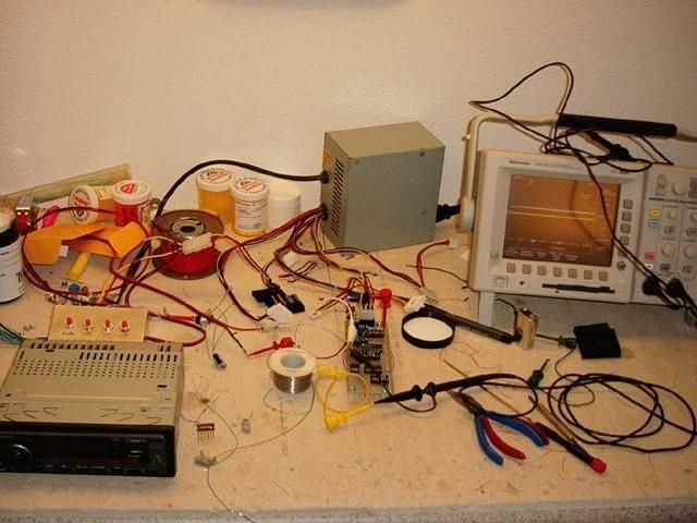

Well, after a couple of days of not really feeling like doing anything, I am back working on the dash controls interface. Just wanted to let people know that work is still progressing. Here is a pic of the circuit on the bench:
On the left is the Sony deck I am using for testing, and above it is the 'S2000 Simulator', a little box I wired up that duplicates the S2000 dash controls. In the middle is the wire-wrap board with the circuit on it and it is currently undergoing testing and measurements. Fine tuning and optimization of both the circuit and the software is proceeding very well. I'll keep you all posted.

So what's the status of this project?
I just recently got an Empeg player for my car, and want to retain some sort of control via the dash controls. The tuner module for the empeg has an input for the sony remotes. I'd definately prefer this to doing a custom serial solution.

pellis:
I am still working on the prototype, wiring is complete and I am testing and optimizing both the components and programming.
As far as the led and 1/8" connector, this would probably work OK, but it would not work with the circuit that I am producing. This circuit does not emulate a sony infra-red remote control. The Sony decks that have 1/8" decks have special circuitry in them that has nothing to do with the infra red remote, therefore wiring up a jack to it's led won't help.
Also, it is possible that the circuit I am creating could do serial based control. After I am completely done with the Sony deck control I may look into this. I have made sure to design the circuit so that the hardware is in place for serial control, however, there is currently no software support for it. If the empeg can receive serial commands at 9600 8N1, then the programming should be relatively easy.
Also, I'd like to mention that when I originally started this project, my intention was to create something for myself to use in my own car. However with all of the interest that I have received in the form of responses on this thread and personal e-mails, I am excited that other people are interested in what I am doing and that I may be able to solve this same problem for others. I am working hard to ensure that I create a solid, reliable, well thought solution. It is taking a lot longer than I expected, but hopefully others will find it useful. I'll keep you posted.
