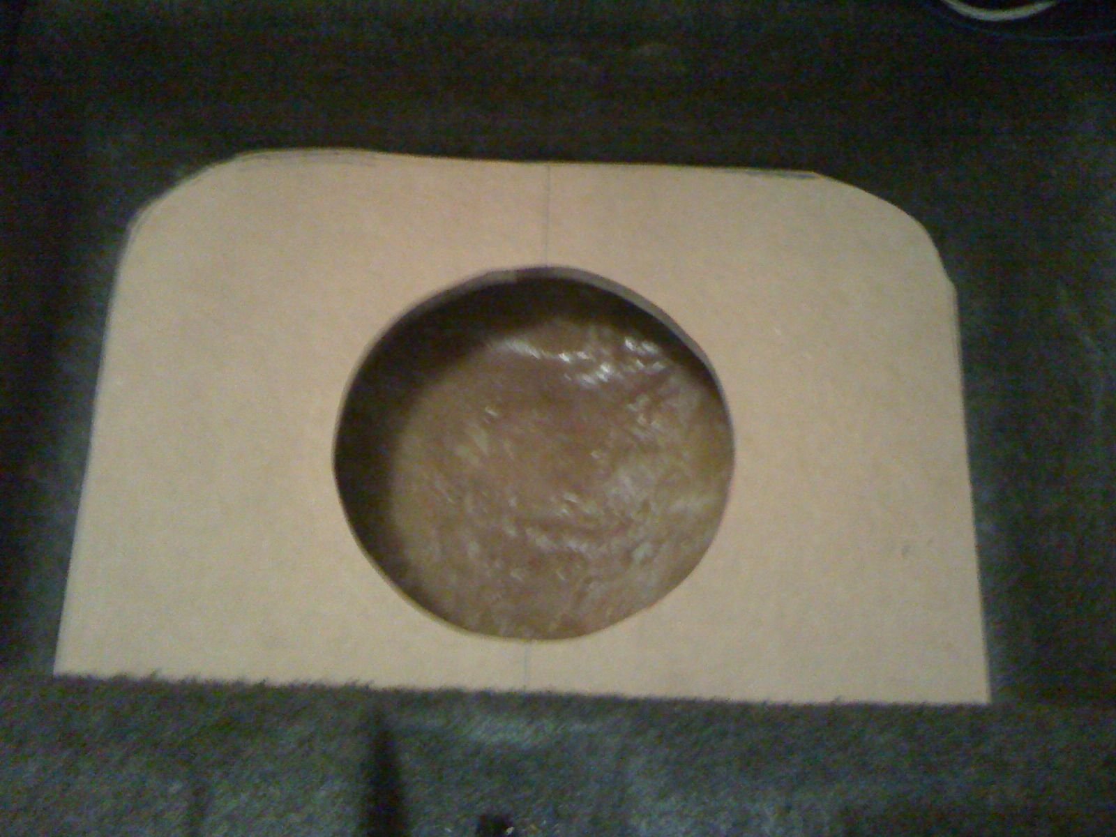

The next thing to do was creating the MDF top and bonding it to the fiberglass tub. I used ¾” MDF and used the piece that sits on top of the foam tool well as my template. I traced the template onto the MDF and retraced (measure twice, cut once!) before taking the jigsaw and cutting it down to the template. I then went on to draw some centering lines and used a compass to draw a circle corresponding to the correct diameter needed to get the subwoofer to fit perfectly. Again, use the jigsaw to cut the hole to size.
The edges and corners of the MDF top was then roughed up with low grit sandpaper and bonded to the fiberglass tub using more fiberglass and resin. At this point I drilled a tiny hole in the tub and forced some 12 gauge speaker wire through, I then plugged the whole with some resin to ensure an air tight seal. Once everything had cured it was sanded down to a uniform and clean finish and spray painted black. Carpet was sourced from a local audio shop (Midwest Audio Visions) and 3M adhesive was purchased at an automotive supply store. This was the first time I had attempted to carpet something and admittedly I did a sub-par job on the sides and bottom of the enclosure. This is a non-issue though as it’s not noticeable.
