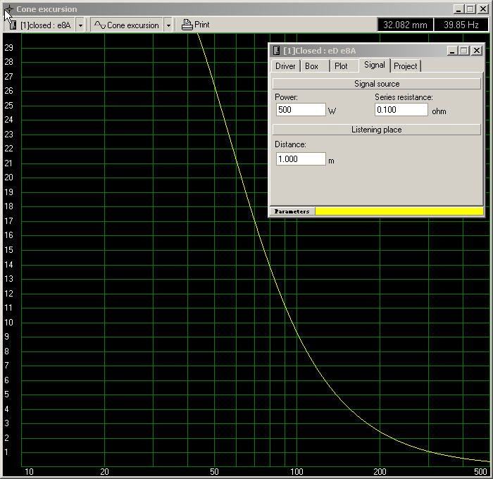

OK... I'm confused now... I'm using winISD pro available from http://www.linearteam.dk . The plot just I did (don't tell my boss! ), using .38 as the box size came out with 500Watts to reach xmax @ 39.85Hz. Here's the graph:
Here's a breakdown of what I came up with:
Power ------- Frequency @ Xmax
500 Watts -- 39.85 Hz
450 Watts -- 36.70 Hz
400 Watts -- 32.43 Hz
350 Watts -- 26.55 Hz
300 Watts -- 16.78 Hz
Looks like the more power you feed it, the more carefully you should adjust your filters. I'm not sure if the T/S parameters have changed, or if I was just given the 'safe' answer without anyone doing a plot... Based on my plot, I think I'm definitely going to hook up the memphis 500D to it, though.

this definately makes me feel better about using the ZR240. i really have no true idea of what it's output will be when i'm at 2ohms... as the birth sheet shows an actual power of 363Wrms @ 4 ohms @ 14.4V for a rated 240Wrms.
still, i went back and double checked my manual just to be sure (vs just going from memory), and i was off by a good chunk for the output at 2ohms.... it isn't 400Wrms, it's 300Wrms! so, it looks as if i'll still be in the safe zone, but i'll probably be right at the edge... not at 550, but at 450Wrms instead... (DOH!)
still my estimated power of 450Wrms is based on a fairly simplistic (and possibly wrong) assumption that the amp will scale up linearly.
either way though, thanks SC for putting my (and possibly your) fears to rest.
