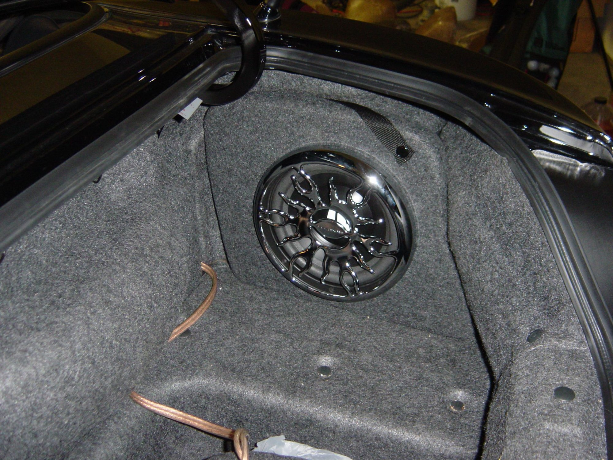

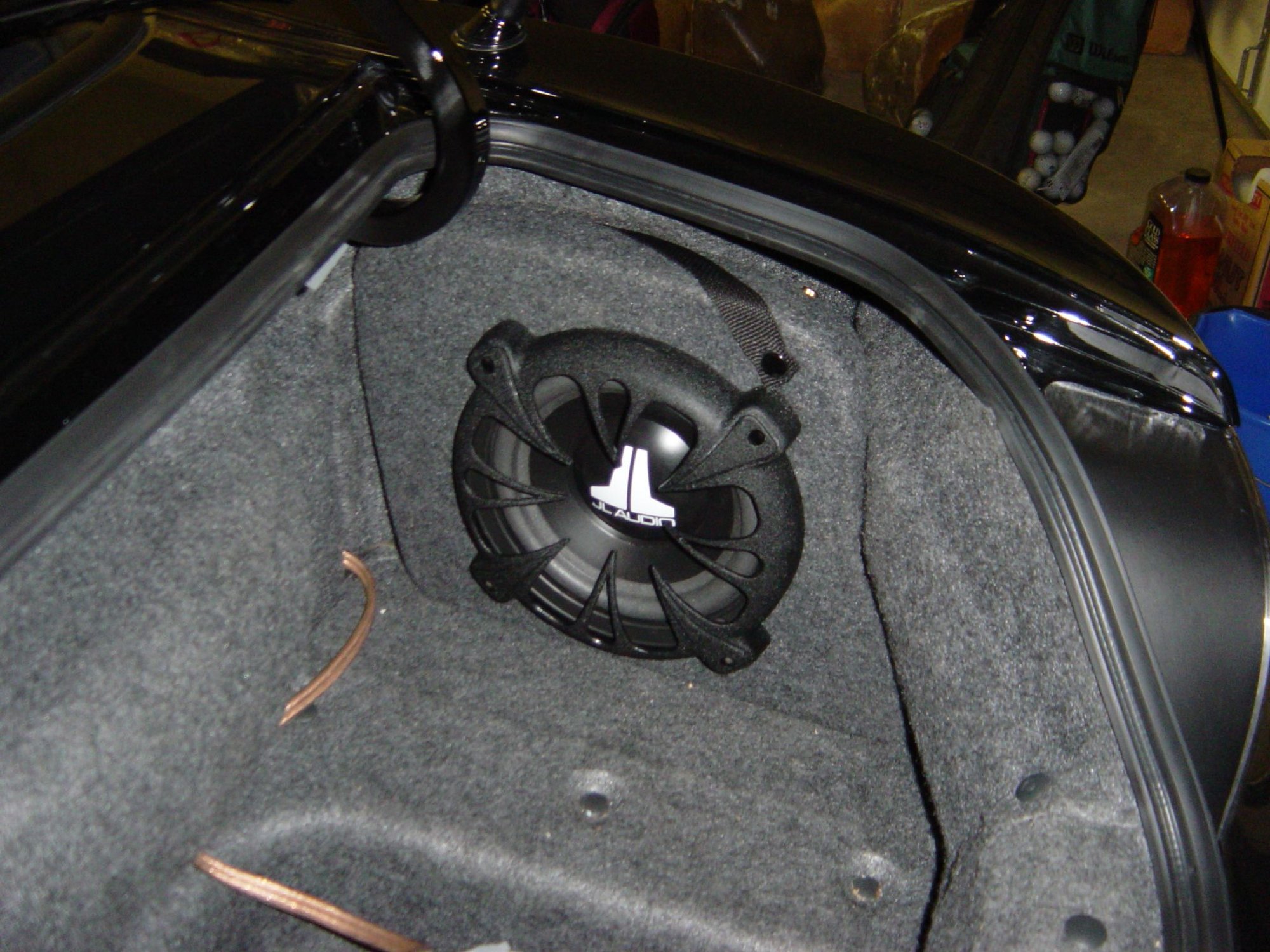

I was mounting a JL 8W3 for another this weekend and decided to take a couple of pics of the Kicker and Audiobahn Grill options. Unfortunately my distributor did not have the black-oxide Audiobahn grills in stock so you will get a view of bling-bling chrome one.
I am 85% confident that either will work with the flat-cone driver on the e8a - but we will see once one gets mounted. I think the Kicker looks the best and it is the more sturdy than the Audiobahn.

hrm. kicker does look good... audiobahn looks to perhaps give more protection? both look to have a curve in section in the middle though... (*shrug*) still, they both look to be pretty deep, and i'm guessing will be eventually tested anyway...
approx price for either?
i think i'm favoring the kicker.
thanks for the pics!

I will have to wait for SC's e8a to arrive before firming up the clearance issue.
The price for the Kicker Grill is $20 and the Audiobahn Grill will be $15.
The Kicker Grill is cast aluminum and the Audiobahn Grill is stamped steel.
I appears that the e8a will have a rubber ring gasket. I know the Kicker Grill will fit it, but do not believe the Audiobahn Grill will work unless you remove the ring gasket. Since we are working in the "sealed box" world I think the gasket is a must.
