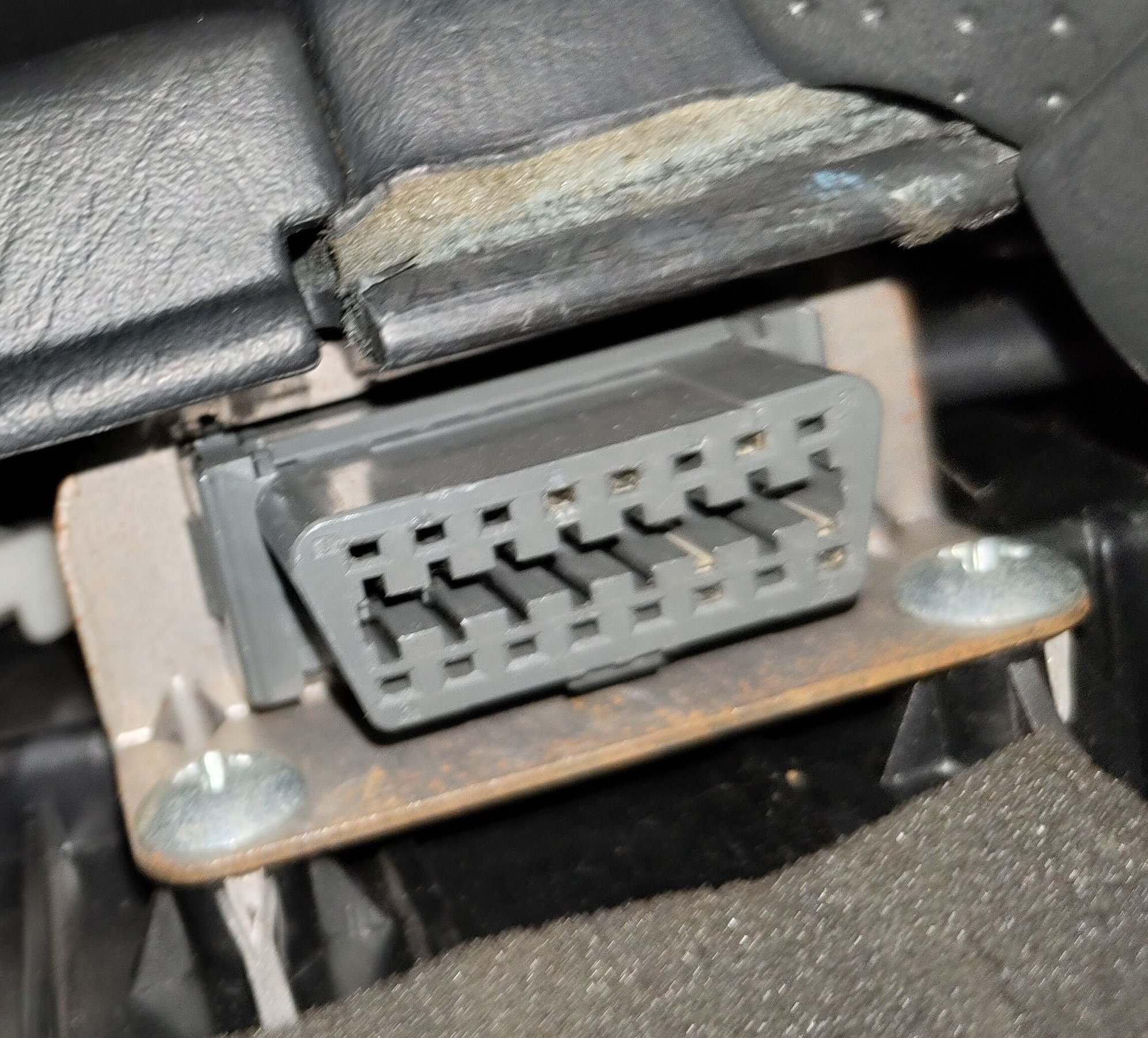

Thank youWould you be able to confirm which pins I need to connect the paperclip to from my attached photo?
the last thing I want to do is damage my ECU

Plug pin out bottom of page
Cannot pull code from OBD-2 Port (Answers requested!) - S2KI Honda S2000 Forums

With the car off, and the wheel straight do the following
1. Using a paper clip or backprobes, connect PIN 9 to PIN 4 on the ODBII connector.
2. Turn the steering wheel 45 degrees to the left
3. Turn the ignition switch on (II)
4. The EPS Light will be on for 4 seconds, when it goes out do step 5
5. Turn the steering wheel Straight, and release
6. The EPS Light will turn on in 4 seconds, when it goes out do step 7
7. Turn the steering wheel 45 degrees to the left
8. The EPS Light will be on for 4 seconds, when it goes out do step 9
9. Turn the steering wheel Straight, and release
now the EPS light will blink twice after you relase the wheel, within 4 seconds. then it will blink 5 times.
If the EPS light stays on, you will have to do this process again.
Another link with more information.
There may be subtle differences between the US and UK OBD2 ports I'm unaware of.
