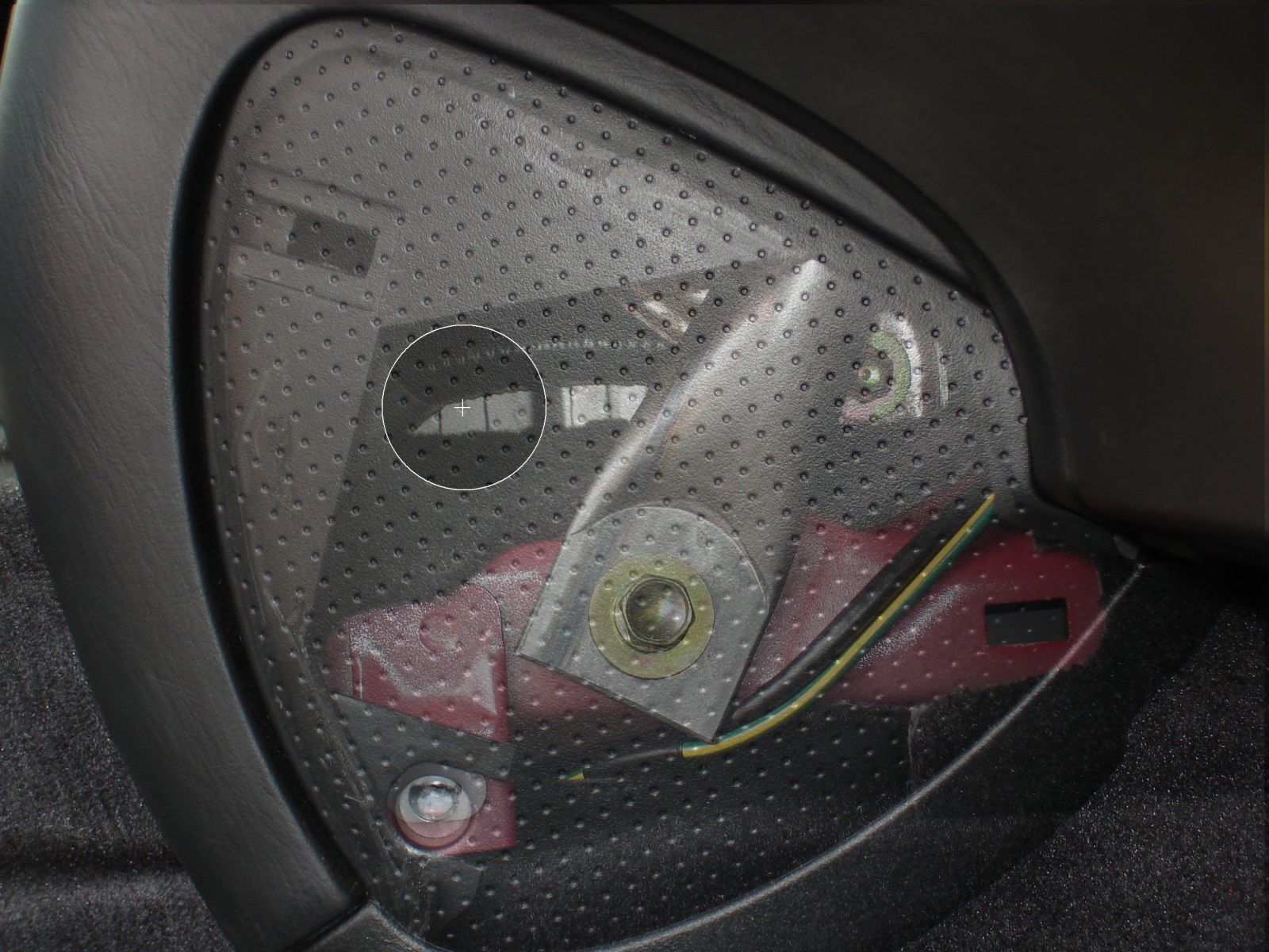

I wanted to add an accessory power socket to plug my GPS into and was going to mount the socket on a bracket under the passenger-side dash. I really wanted something more professional looking...which is exactly what I found with ronblanford's idea.
However, I wasn't real sure about taking measurements and trying to transfer those to the plastic panel. There isn't much room for error so I wanted something "exact."
A little photoshop will get you the picture below. Fortunately, the panel is covered with a bunch of little dimples. Locating the precise dimple in the photograph, I knew right where to drill. What do you know?! It's even center tapped
I'm not sure if all MY's have the same dimple pattern as my 01, but compare your panel to my picture. If the dimples are the same, then start from the 4th of 5 dimples in the top left corner of the panel. Then count down 15 to find the right spot
Hopefully someone will find this useful!
-Pat
