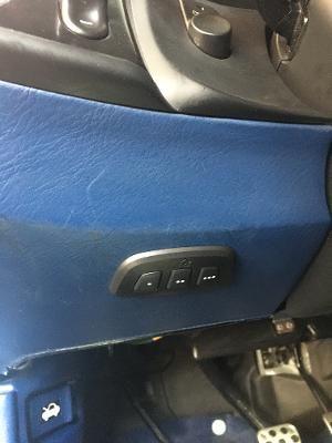

Got tired of hiding and looking/reaching for 3 different entry-gate and garage door openers. Picked up a brand new Gentex HomeLink 5 Module (Model #ADVGENHL5ALL) on Ebay for $110. Took about an hour cutting the hole, wiring (just a constant 12v and a lighting circuit) and tie-wrapping/clean-up.
I'm happy with this location and getting rid of three separate transmitters.
