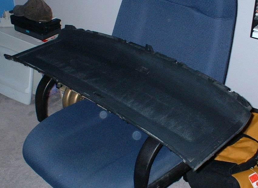

repost pic please.. i cant see it and im putting a sub in next week!
It's the rear tray behind the seats that seperate the cabin from the trunk. The soft top folds down and rests on it. The top still works fine and the plastic window doesn't touch anything with it removed.

anyone know HOW to remove it? sticking my head back there with the top up is hard enough.. i dunno about unscrewing ish and actually having the room to pull that whole thing out.. what exactly holds it in?

I have a Muz mat so what should I do if I remove that piece? Also, how do I remove it?

I have a Muz mat as well. With this tray removed you don't need it because the plastic window doesn't touch anything when the top is down.
All you do is remove all the clips. Take out the rear tray rear trim first which is easy. Once you remove all the "B" clips from the rear tray, go in through the trunk and push up on the bottom of the tray (there's insulation on this part) to pop the "A" clips along the back. NOTE: You will need to remove the trunk lining along the back so you can get at the tray through the trunk. Once it is free from all the clips you have to tilt the front up (where the "B" clips were) and try to tilt it on an angle so you can get it out through the trunk.
What I did was lift up on the front part (closest to the back of the seats where the "B" clips were. Then I lifted up on the right side (Drivers side) so it was on an angle. Then fed it though the new hole out through the trunk on the passenger side. You will probably have to remove the spare tire before hand.
