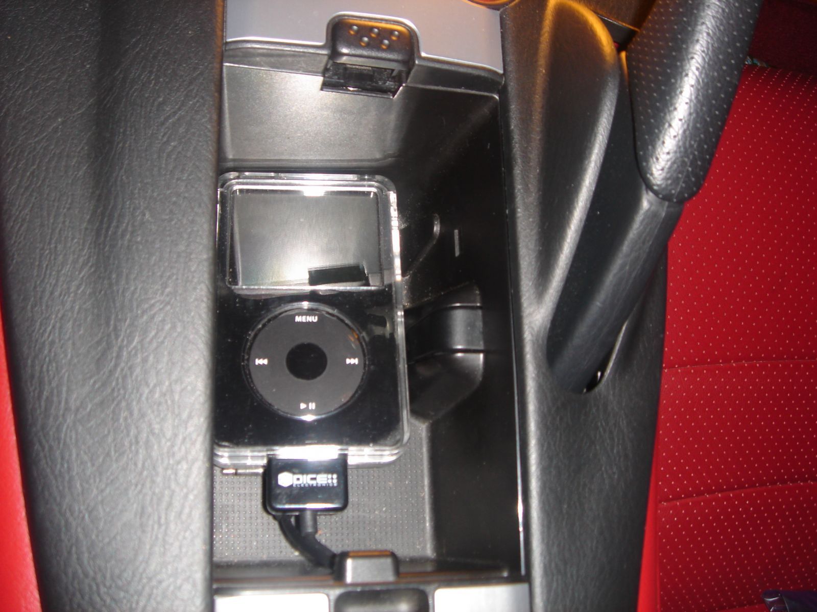

Mine is sorta tough to see in this picture, but here:
The cable was run straight back from the radio under the cupholder. I pulled all the trim from the back of the trunk and if memory serves, you can drill a hole from there. Run the Ipod cable under the glove box and then up into the hole you drilled. I finished mine with a rubber grommet. The best way is actually to thread the cable into the glove box first, and then around back under the cupholder. That way you don't have to drill a bigger hole to fit the end of the cable through that connects to the Ipod.
