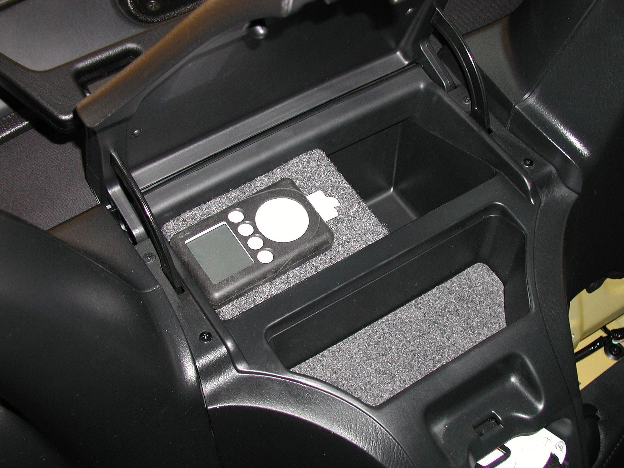

I have the same basic setup, with the iPod controller under the passenger seat and the iPod itself in the "secret" compartment. I tend to leave it in the car for days at a time and thought this would be the most stealthy. Plus, it's very easy to get to the bottom of the compartment from the trunk area for wiring. I just made a simple pedestal for the iPod to sit on.

I did this last year, works great
I drilled a hole in the bottom of the secret compartment, cut a piece of carpet that matches the other compartment, cust a cross in that and fed the wire through. I used marine vecro with an ipod case and just stuck it to the wall of the compartment. I have autocrossed the car with the ipod inplace and never had a problem.
