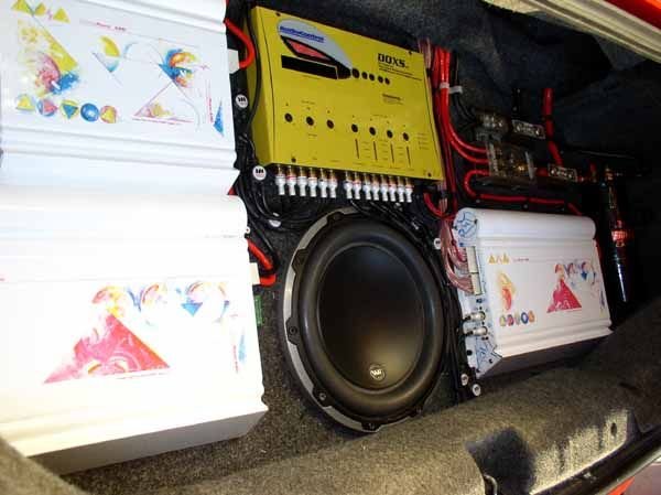

Originally Posted by thraak,Feb 6 2008, 06:43 PM
Freek,
You definitely don't need anything in the back. But, it sure is nice. I originally chose to mount my rear speakers on the rear panels.
I have used this setup for 2 years. You still get rear fill, but so much is blocked. I also mounted the passive x-overs on the panels for the rear speakers.
This took away legroom from my taller passengers.
I also use an AudioControl active x-over-eq.
I have heard the S-PODS and was personally blown away.
I am in the middle of "re-doing" my trunk now so that I can also carry around my spare and jack.
It is not complete yet:
Alpine DVA-9861 DVD receiver
130 sq. ft. Dynamat X-treme
(2) 200 watt PPI A404 Art series amps
(1) PPI A-200 Art series amp
Audio Contol DQXS Digital x-over/Eq. with DDC remote control
JLAudio 10W6v2 sub.
Focal K2P 165 Components
K2 130 components
Streetwires 1 Farad Cap
Streetwires and MonsterCable wire, distributions, fuse blocks and interconnects.
Clifford 2-way paging alarm with dual proximity sensors
Next week: S-PODS. And if Georgie B. shows me the money, I may hook up a little widescreen monitor to my alpine video out jack. Or, add Xm or Sirius or an HD Radio converter.
Good Luck, I'll keep you posted on them SPODS.
Thraak
