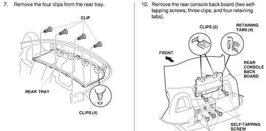

Originally Posted by dbourne,Nov 24 2006, 07:52 PM
The black clips, marked with red arrows, are just pried off with a tape covered screwdriver?
OK, it was just a matter of prying off with a flat screwdriver (or door panel remover). I haven't had the car for a month yet ... so didn't want to break it too much.
It doesn't seem that you have to remove the whole 'left trunk side trim panel' although it is probably easier with it off. However, the instruction "Push in. Push out" didn't seem to work with the first one I tried. Maybe push part way and pry out? It didn't pop out! Should that read 'push in pull out? Thanks.
I thought I'd try the same installation. I'll leave the full installation in the console to another day. I have a silly (simple) question. The black clips, marked with red arrows, are just pried off with a tape covered screwdriver? Sorry these are the simple steps that cause me the most trouble. I suppose the worst that would happen is breaking the clip but I'd like to do it properly. Some of these clips are recessed and not easy to approach. Thanks.
I've already managed to push on the center of one clip, marked with blue arrow, into the space below, behind the bumper. I have to assume they are disposible on removal.
the connection is located behind the panel to the left of the bulge where the spare is located, so i didn't even need to pull off the panel you have pictured
yes, you can pry off the red-arrowed plastic screw with a flatheaded screwdriver. the other type of screw can just be pulled right off. take off that panel and you will find the connections. and it's just plug and play from there. i even left the music link unit in sitting in the spare tire. all that is visible is the wire that attaches to the ipod.

Originally Posted by dbourne,Nov 29 2006, 07:54 AM
Thanks for the feedback. I'm still curious about the 'blue' plugs. I have a couple of replacements on order with the iLink so I'll reverse engineer them when they arrive ;-). I'm guessing one short push of the center pin will allow the removal. I think my second push broke some plastic captive piece or simply pushed it all the way through ... with winter weather approaching I may have some more non driving time with my car. I have enjoyed the last three weeks and 1400 miles though :-) Driving home from work, top down, is a great way to clear the day's cobwebs.
I think I worked out the blue plug, pry out slightly, press the center pin slightly and continue pulling.
I've been exploring the 'full' iLink installation. It starts with the removal of panels behind the two sets. On my '06 there are two bolts to remove on each side.
After removing the bolts the panel can be removed by gently pulling from the bottom.
The next step involved removing trim, shelf and rear console back board. It looked difficult.
It seems that routing the cable between cabin and trunk doesn't need this step. Is it required to remove the rear console? Those three self-tapping screws at the bottom, back of the console may need to be removed. These steps may be the deal breaker for me...
I've been able pull a piece of cable from cabin to trunk, marked with blue arrow below.
However, if the rear console can't be removed, drilling the 20 mm hole isn't possible...is this going to be a problem if I don't take the rear tray etc. off?
