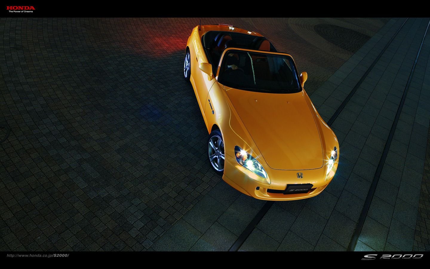

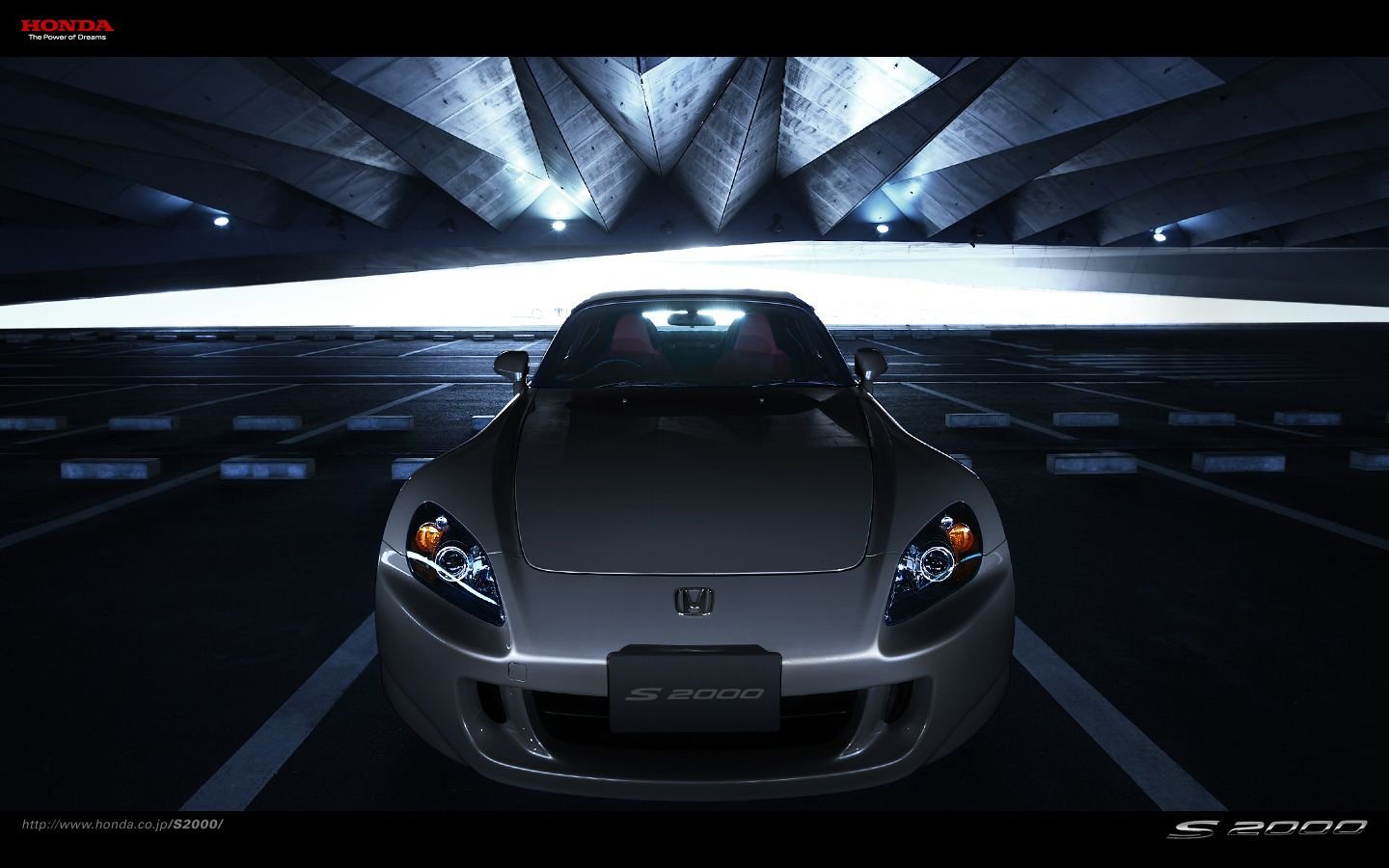

In Japan, they are white, fyi. The look pretty good. Some people "clear" their headlights by taking the assembly apart and removing the orange filters.

I replaced mines with LED bulbs.
They look more clean, and they also match my 6000k HIDs, but I still needa clear/smoke the orange reflectors inside to complete the look.
