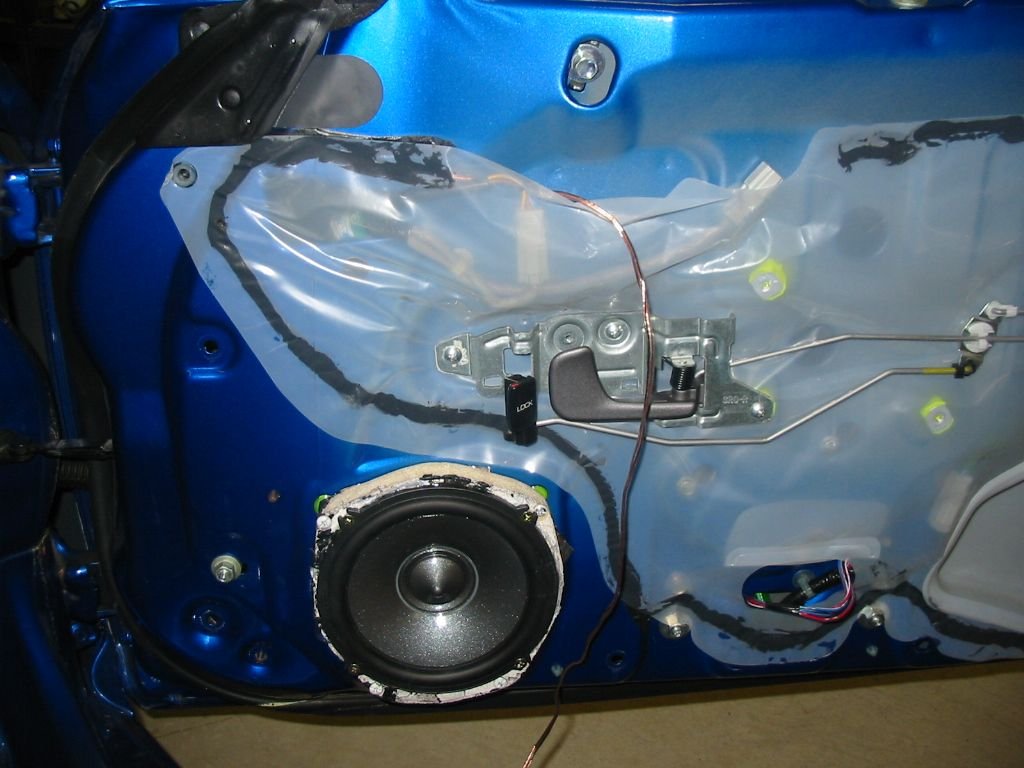

Had to make speaker brackets out of 3/4" MDF and that took some time. These Alpine Type R 6.5" components are HUGE! Tweeters are mounted in the door panels. They actually used the stock screw locations...CRAZY! The 6.5" are what is taking the time. I have attached them to the MDF and used flexible gasket to seal them. Letting them sit overnight to cure.
I dynamated the speaker cutouts in the door frames and now need to dynamat behind the speaker area inside the door. Looks like the PDX-5 Amp is going in a tray that I am going to make that sits inside the spare tire.

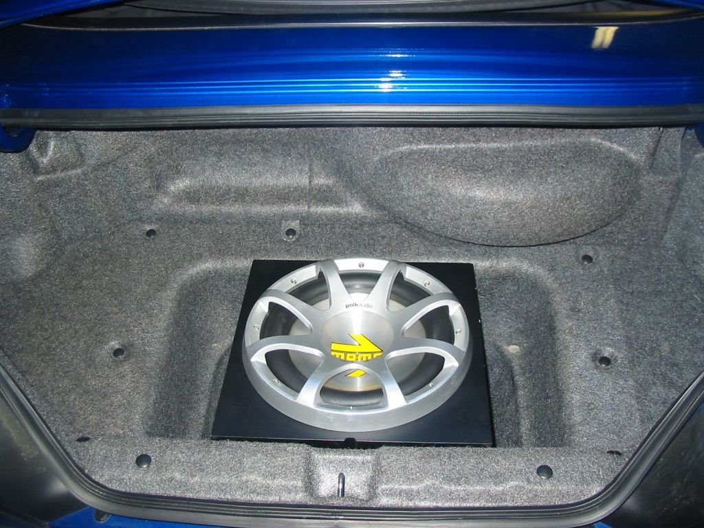

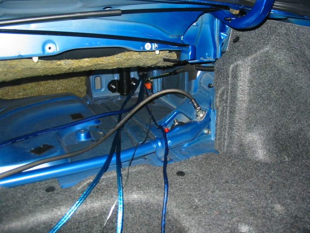

I am not sure I am going to leave the sub the way it is, I may buy a S2000 specific enclosure for it. I ended up mounting the amp over the gas tank. Fits perfect. This allowed me to keep the spare tire and put the tools in the inside of the spare tire wrapped in towels.

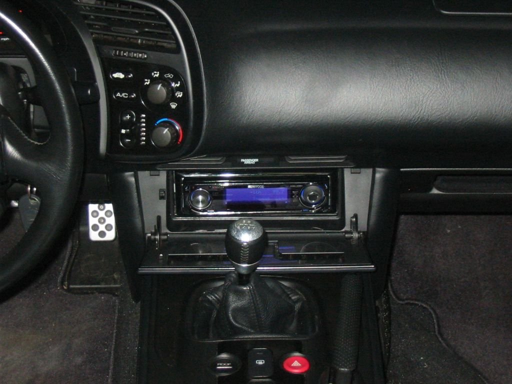

The Modifry wired DCI-2 works great with the Excelon KDC-X891. I hooked up the SCV at settings 4 and 6 as well. Works pretty well. I like setting number 6 the best. I mounted it beside the radio behind the small panel next the passenger's knee area so I can adjust settings if needed.

I sanded down the paint to bare metal to attached the ground cable. A good ground is key to any audio system install.
Alpine Type R 6.5" mid-woofer installed using 3/4" MDF spacer with dynamat behind and MDF sealed with clear goop sealant.

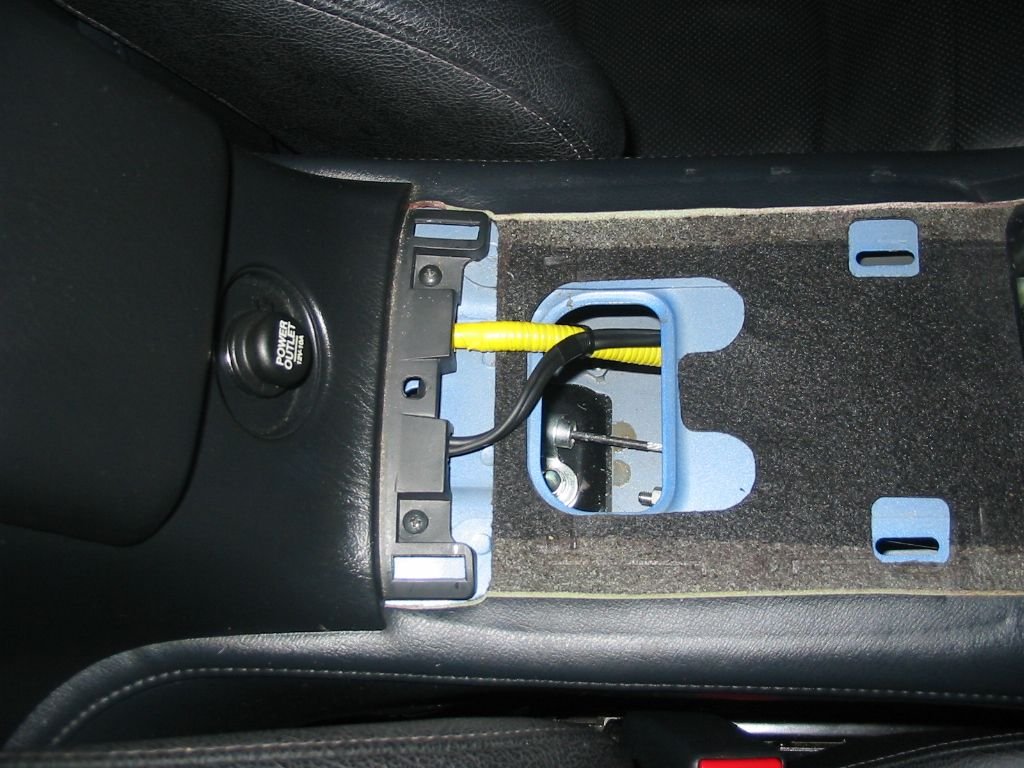

Ipod adapter cable KCA-IP200 run through the center console up to the first secret compartment.
KCA-IP200 cable
Super tight fit for all of this stuff to go behind the radio. I had to adjust wires a few times to make sure nothing got pinched. Modifry DCI-2 mounted to the right of the radio behind the triangular panel near the passenger's left knee area.

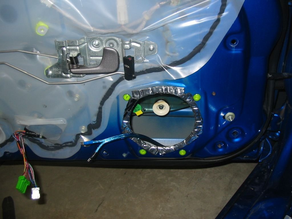

Dynamat around speaker opening and wiring for the crossover. The crossover was mounted in the door close to the speaker.

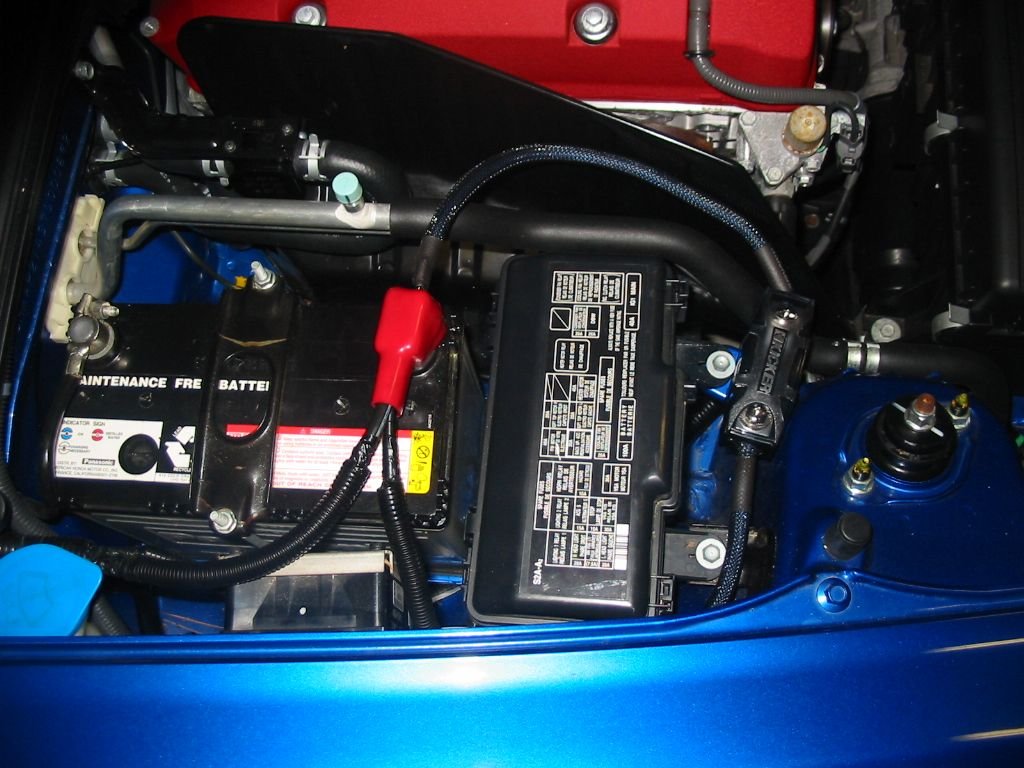

I mounted the 100 amp fuse holder in front of the battery and mounted it to the bracket that was already there.

Polk MOMO MM12 sub and enclosure. Ok for now, but I may buy the specific S2000 box for a cleaner look.
Kenwood Excelon KDC-X891 head unit. This is a head unit I bought in 2007 and still had laying around. Provides 5-volt pre-outs and clean signal.
