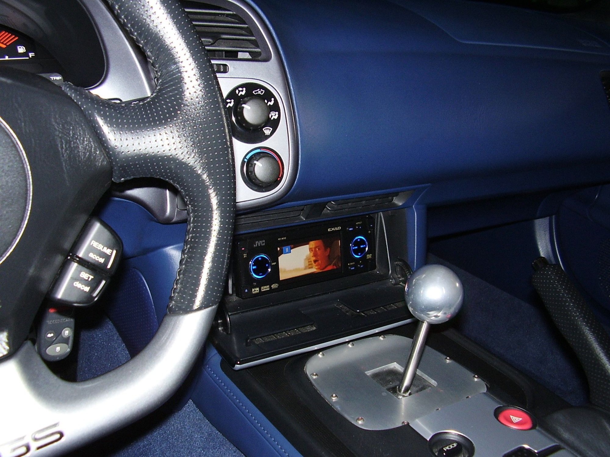

I have done a few new changes to my system. Over the years I have had about 3 different systems in the car and this is the latest upgrades I have made.
New head unit: JVC EXAD KD-AVX2
Door speakers: Boston Pro 6

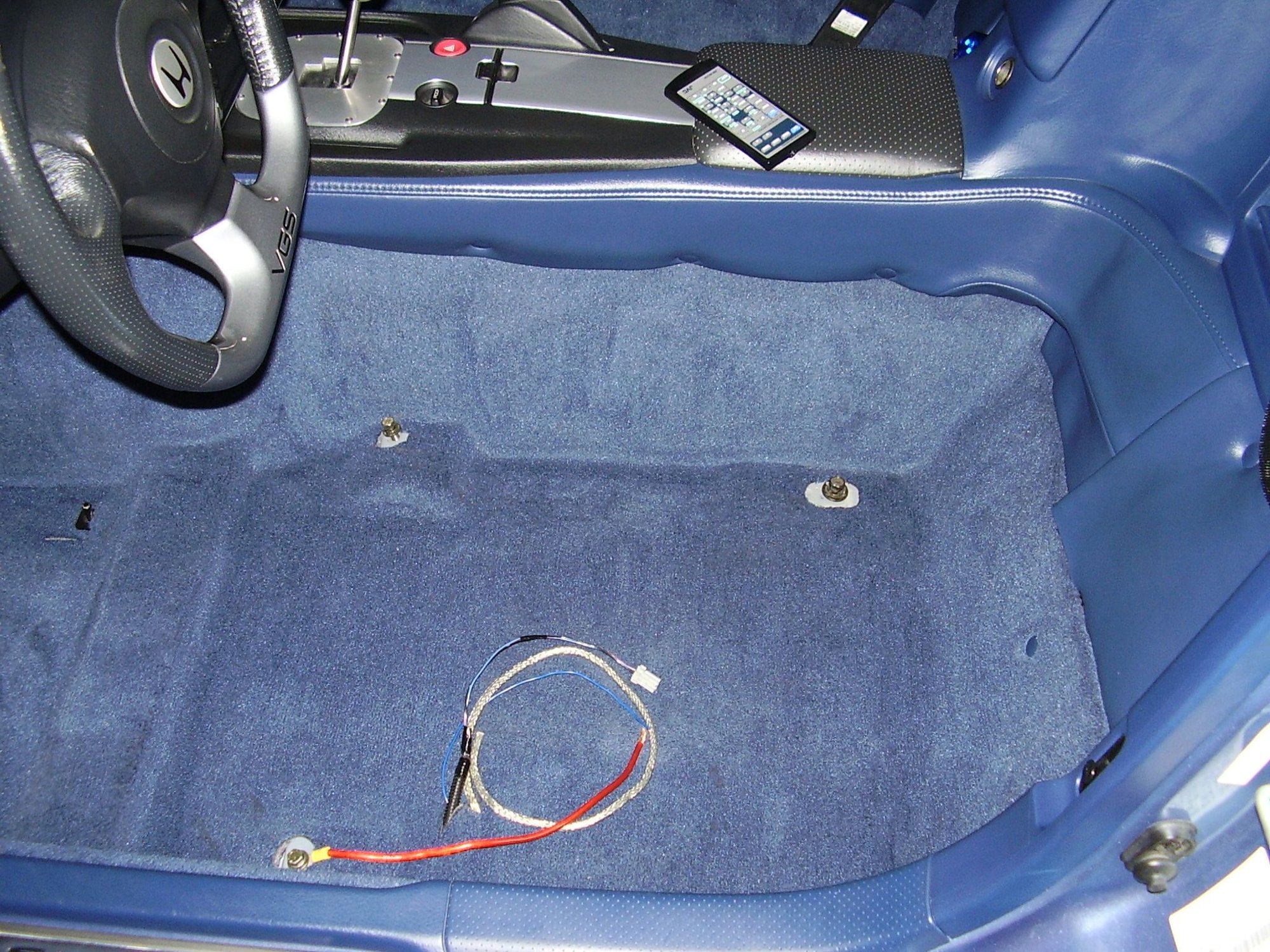

Tweats behind vents in factory panel
reverse magnets make for an easy install of a 5 1/4" speaker
trim on grils painted to mach the car colors Suzuka Blue/silver
Boston GT- 20 Amp for rear speakers under passenger seat
Stinger digital distribution block
wired for JVS 6" powerd sub
Audiobahn digital fuse link

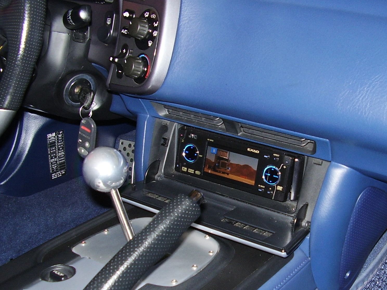

I set the tri pod of the camera at drivers head height to give you guys an idea of how the 3.5" screen size is to view.
passenger view of screen

lol @ fast and furious on HU.
How does the head unit fit? Does the door close correctly?
It fits very nice Yes and no on the door closing, no it dose not close all the way right now but, it will after a slight modification to the mounting brackets
