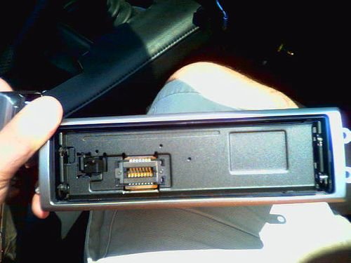

Anyhow, I removed the faceplate and didn't help. Excuse my ignorance, but I'm not sure how to check the internal amp, think its in the setup menu under P-IC (which shows ON) but not sure. Also I can't find a reset button. I'll post a pic of the plate under faceplate tomorrow and maybe you can show me. Thanks for the guidance.

Well NFRs2000NYC, looks like you're onto it here. I pulled the HU and turns out the fan is NOT spinning.
I do have aftermarket speakers.
By the way, here's the pick of the front panel behind the faceplate. I'm I missing the reset somewhere?
Any ideas? Is it a bad HU? Is there someway to maybe reset this thing?

Yes..theer is a button (either at the back of at the front (withouth the faceplate) that says reset and needs to be hit with a ballpoint pen. Hopefully, that will take care of the problem.
If not, try scrolling though the menu and making sure INT is ON not off.

And by the way, I still don't see any reset button on this thing, even though the manual clearly makes reference to a reset function in the troubleshooting section. Just doesn't actually show or tell where the damn thing is.
