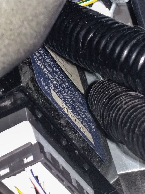

Can you snag a picture of all of the wires that come out of the central locking module?
It's possible someone removed/cut the ignition wire to allow the fob to work when the car is on. This will not allow the module to go into learning mode as it cannot see the IG on/off sequence you are entering..
