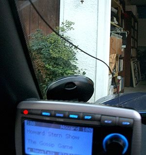

The main view of my radio with the wires hidden. You can still see part of the power wire at the bottom left corner of the gauge cluster. From there it snakes out of sight in between the top of the steering column and the dash. This pic makes it look like it blocks my view significantly but my head actually sits about a foot higher than where the camera is so it isn't bad at all. Hmm, I probably should have closed my garage...
In this image I pulled out the FM antenna to show you where it is. Normally it's hidden inside the A-pillar so you can't see it. I also use this rubbery mastic tape on the top left and bottom right corners of the unit to insulate it from the pillar and the dash. Since it basically rests wedged in there I wanted to eliminate vibration and prevent getting any scuff marks. It's barely visible as the black lump at the top left of the unit and it works great.

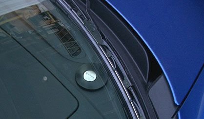

Here is a pic of where the satellite antenna is from outside of the car. The (way too long, btw) wire hides along the front of the dash to a bundle behind the receiver on the other side. It's hard to tell here but the antenna is oriented so that the Sirius logo is perpendicular to the length of the car. The double sided tape works well at keeping it in place even after sitting in the sun for a while. I tried hiding this in the "secret compartment" before but my signal dropped way too often. It's good about 99% of the time here. Ideally it should be grounded on top of some metal but there's no way that I'm putting it outside of my car.

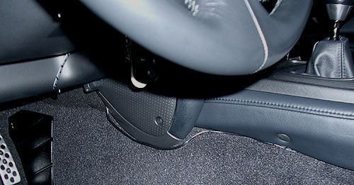

This shows where I have the power cable hidden next to the center console. I didn't want to have it inside the console itself just in case if I ever need to take it out quickly (road trip in different car, detailing, etc.) so this works out well. After it comes out near the back of the steering column (black/white striped wire on the left), it goes back and "hooks" around a corner of the center console piece, so it hangs in place very well. I normally have the wire hidden behind the plastic and leather for some stealthiness but I pulled it out so you can see the path.

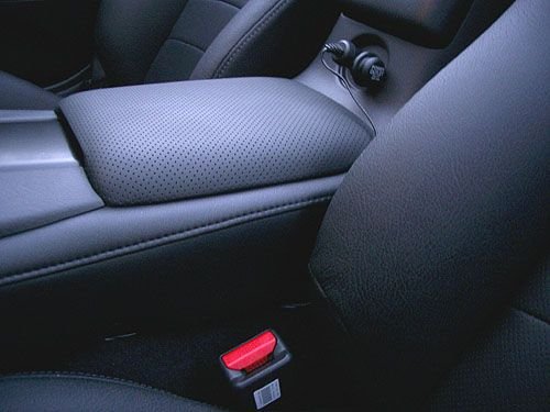

Finally, the wire comes out from the leather part right behind my seat and plugs into the outlet. If I ever need to use the outlet for something else, like a cell phone charger, I just pull it out and lay it across toward the passenger side. It sucks having to listen to crappy regular radio when I do this so it doesn't happen very often but at least I know it won't pull the wire out and ruin my setup.
