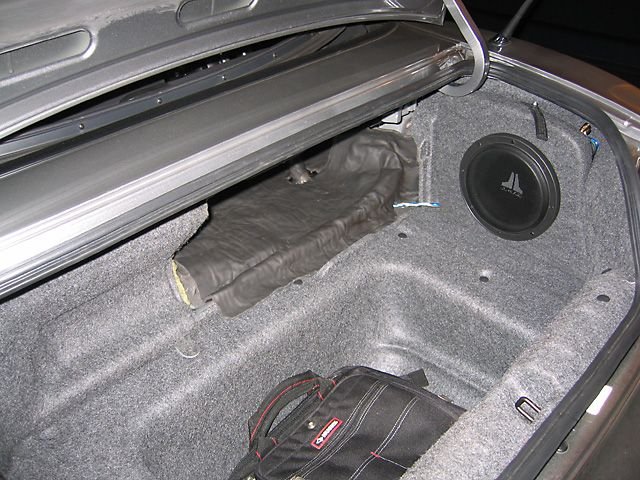

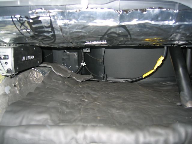

I ended up with something similar to this after I had a roll bar installed in my car for track use. We ended up removing the OEM roll hoops and since the new bar provided far more stiffness that the OEM roll hoop cross bar frame, we removed it as well and mounted the seat belt retractors on the cross member of the new roll bar. This left the whole area between the trunk and the cockpit completely open and with one of the new roll bar legs welded directly frame where the spare tire used to be, the spare wasn't going back into that spot.
I used a couple of layers of sound deadeners in this whole area - Dynamat extreme followed by 3 coats of Quiet Car and then I added another layer of dynamt for good measure.
To cover all of this up, I had some leftover sound deadener from a previous car laying around called VBLOK 3. This is a 2 layer closed cell foam with a lead sheet in the middle. I cut that to shape and layed it out to cover the whole space. This shot makes it look somewhat gray because of the flash, but it is black in daylight.
The smooth surface you are looking at is the back of the passenger seat since I have no trim behind the seat area anymore. You can also see the passenger side rear roll bar brace on the righ hand side of the photo.
VBLOK 3 is kind of pricey ($179 for a 12 sq ft sheet), but works very well and is easily molded to the countours with the lead layer in the middle. The surface could be made to look nicer than what you see here, but I am using stuff that had previously been in another car first and wasn't smooth when I started.
I am using an 8" jl Audio sub in a wlaurent enclosure and get very usable bass up front. The sound deadening helps a lot.
