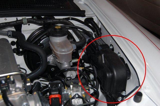

On your 07, take the cover off the throttle sensor, helped me out a bit. It's the cover in front of and to the drivers side of the brake master cylinder.

By the way, can you circle what your talking about here?

Circled in photo below.
