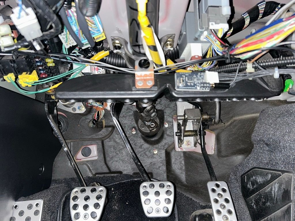

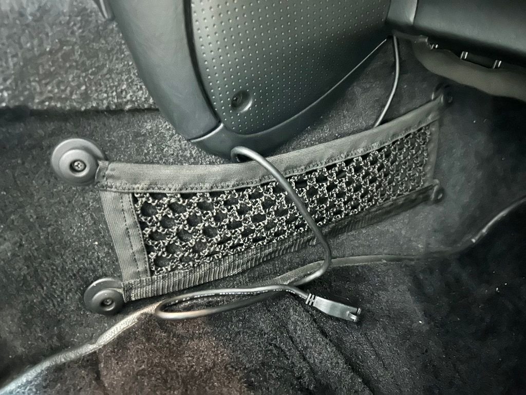

I mounted the DCI under the dash where the wires for the camera, GPS, and reverse signal went. The USB dongle from the head unit went in the passenger storage net.

That's very interesting as I all did was plug in the Modrify harness, DCI etc, I totally didn't even think about the GPS as when I was watching Youtube installs it was never mentioned.
And my Apple Car Play setup totally works fine.

Speaking of DCI, the YouTube install videos with the Modifry harness and DCI keep the DCI out from behind the HU and tuck it in the passenger storage net. Once it is set up and working, is there any need to keep it out and handy? Couldn't you tidy things up a little and keep it out of the way behind the HU? Thanks!
I think the DCI was instructed to be kept away from HU for heat purposes too.
