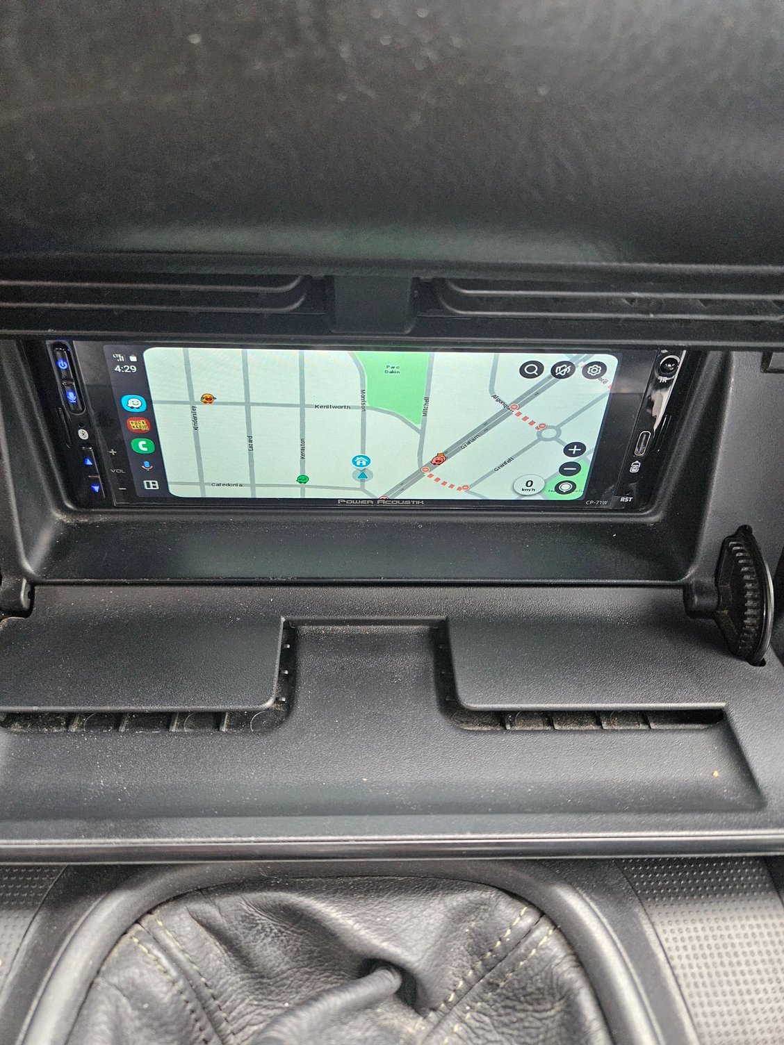

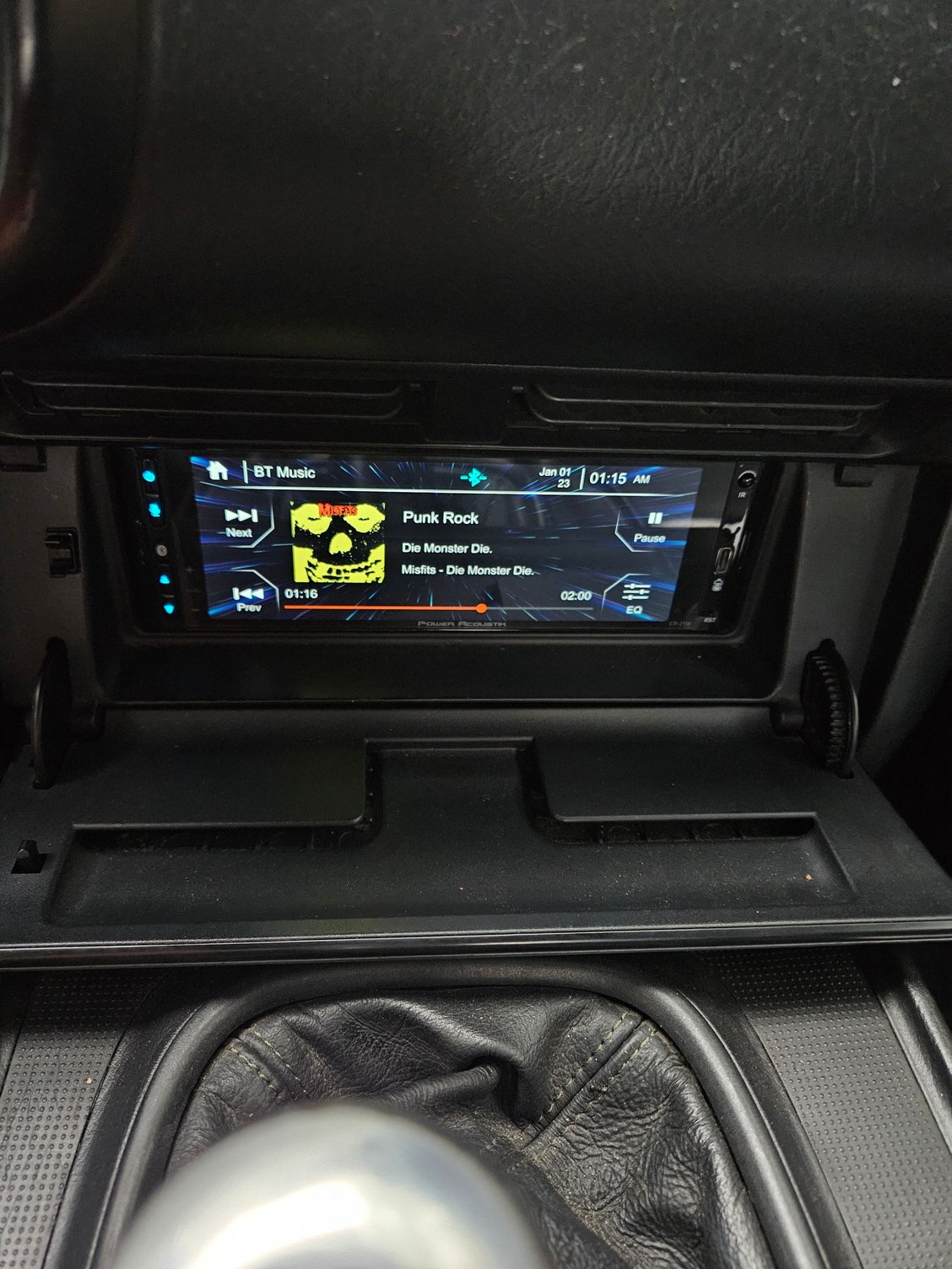

Just installed the CP-71W. It was shockingly easy to do the whole job. Also just did the firmware updates and got Android Auto working easily. So far all good! Door closes with space to spare. I used the Scosche harness HA028-WM1SD. Sound is a bit better than the Kenwood KDC-X997 that it replaced. The bluetooth connects super fast too. Thanks to all posters for the 'help'.
You guys always come through.

Originally Posted by raydouble
Connects almost instantly. No lag. Dash controls work. Rearview camera integration and built-in mic for calls (caller said I sounded clear on other end). Powering JL Audio components. Added an 8” Sony sub in the trunk. Highly recommend, looks and sounds great.
Use the Wal-Mart app, and if it’s sold out (as it was for me at many nearby locations) it might be in stock somewhere.
Power Acoustik CP-71
Does the little door that says S2000 on it close with this installed, thinking about picking one up. not a bad idea
