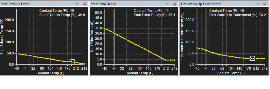

Old Dec 10, 2021 | 06:26 AM
Dwnfrce's Avatar
Joined: Mar 2017
Posts: 153
All right, finally got a chance to drive it yesterday and test. The first shot are the idle settings in the AEM Series 2 that are shown in the video. The second image are what I tried out yesterday which didn't impact the cycling issue. I can screenshot anything else in the tune file, but at this point I'm stumped.
Edit: I had a 'warm' start around 150F and the magnitude of the cycling was less prevalent but still present.

Closing the thread since I could only find a bit of a bandaid. AFRs and ignition timing are fine, i just took the Idle Surge Time down to a couple seconds. Sounds like it's trying to cycle but without the Surge timing it just settles into regular idle quickly and it's smooth from there.
