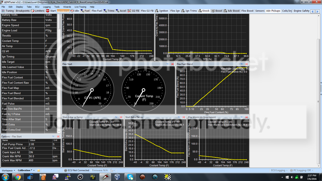

ID2k's // Flex

After reading the Evo forums for their E85 tuning strategies and couple other sites . I was able to get my 1300 to startup on first try. No more 5-6 cranks! It still needs some fine tuning in terms of starting like a stock car but it is 100 times better then what it was. I use to have to crank so much that my battery voltage would drop and i would have to charge the battery.
My currently Ethanol Content is 84% and i'm running ID1300.
this should be a good starting point if you need it.
