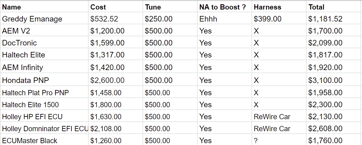

These are Ballpark #'s
Tune is just a basic #'s at $500 for 2 hours of dyno, street ect it could be more or could be less.
I didn't factor in re wiring the car and I was unsure about ECU masters and others but it puts a ballpark at price point.
