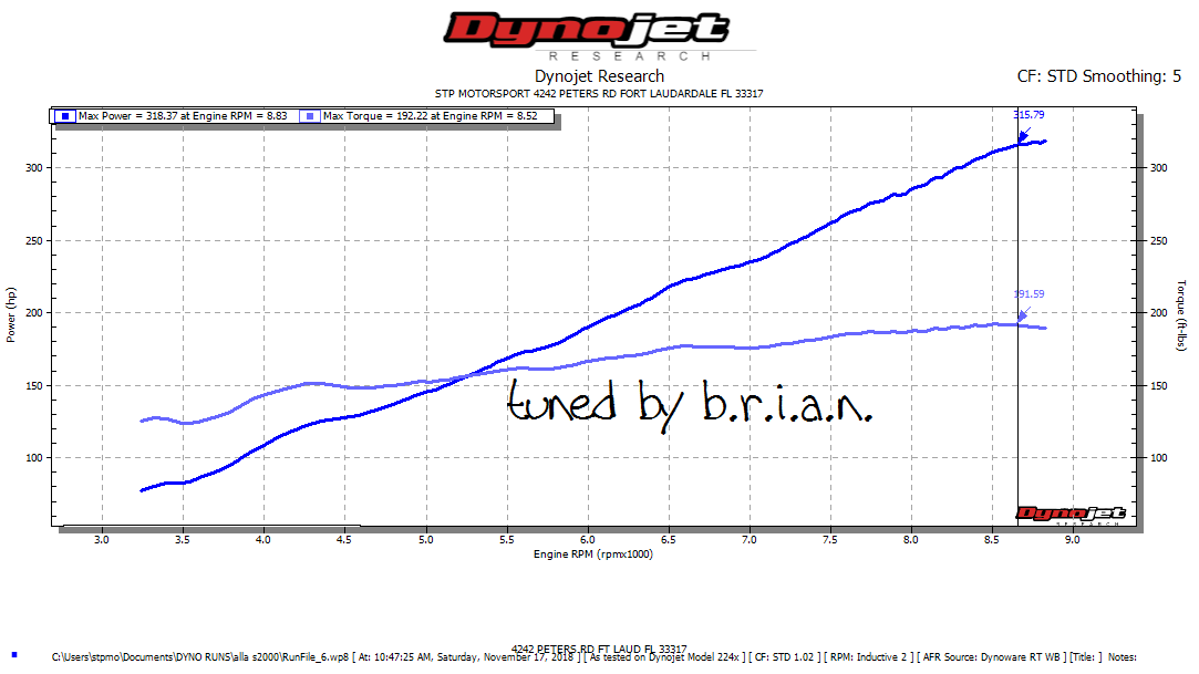

I installed one of these ECUs in my car last week and should be getting it on the dyno later this week. Initial impressions are:
1. Interface is pretty intuitive and similar to KPro, albeit you have less to play with.
2. Support is non-existent. I have tried emailing and calling Doctronics to get some questions answered, but haven't heard back. I did call Ballade and while they DID return my call and talk to me, I got a call from a sales person, not a tuner/tech guy so it wasn't very helpful.
I will report back as I play with it more and get it tuned.

So after getting the car tuned and driving it around for a bit, I'm back to give some of my thoughts on it.
- From a usability perspective, its the same as using K-Manager. Table layouts are the same but some of the keyboard short cuts are different.
- For some reason the Ballade Harness was made incorrectly and I didn't want to redo the harness so I wired my wideband into the ELD Input and I'm using that for closed loop operation. It works well, however, there's a 123 sec delay until it goes into closed loop which is annoying when you first start up the car.
- The quality of the harness itself leaves a lot to be desired. I couldn't de-pin some of the wires so in the end I had to remake it; I couldn't forced the issue, but the plastic felt like it was about to break apart with de-pinning tool. This was especially annoying since I kept getting random emissions CEL, e.g. P0453, that were a result of bad wiring. I was still getting the CELs even when forcing emissions to ready, which is pretty stupid; checking emissions readiness should disable all those CELs.
- The VTEC table is not ideal as it only uses RPM, vehicle speed, and ECT to determine if should go to the high cam. I had to keep my crossover point at 6k RPM; initially it was set to 4300 RPM but the car would want to keep crossing over to the high cam at partial throttle which was not desired. Doctronic should add a TPS parameter as well to resolve this.
- As advertised, its great to have a plug n play solution for AP1s that does not require switching out the sensors. The car started on the first crank using the base maps from Doctronic. Those maps also leave A LOT to be desired. The timing maps are retarded 20 degrees all the way through for some reason.
- You use the Nitrous settings to trigger meth/water injection, which is a workaround since there's no specific input for that.
- Support is limited. They did release a new software version last month, but there's little to no documentation available. I wonder how much longer that's going to last. You can use the K Manager to get a lot of your questions answered and the F1 function in the application itself gives you some information.
- Tables are very limited when compared Hondata/K Manager.
So the million dollar question, would I buy this again over a Hondata? I would. Its considerably cheaper than a Hondata and doesn't require changing sensors and the valve cover. Like I said before, the limited support, lack of tables, and poor wiring is a concern/annoying. Be prepared to spend some time getting setup to work like you want it. Lastly, I got the unit because I need to pass emissions when I move next year. I haven't had a chance to test that yet, but all the readiness tables are 'Complete' per an OBD reader.
