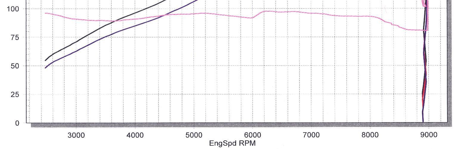

I took my S2000 to a dyno today and did a test run. The AFR measurement was done with the sensor placed behind the exhaust.
Mods:
  • Snorkel "AutoTecknic Carbon Fiber Cooling Plate/Intake Snorkel"
  • K&N FIPK + AEM DryFlow Filter
  • HJS 200er Kat (since ~1.000km)
  • Supersprint Catback
Now I am curious if I am running too lean?
The guy from the dyno said it is still fine but in another forum I got a few people telling me that I am running dangerously lean and could potentially damage my engine.
I could only find a few stock dyno charts with AFR measurements and when comparing them it seems not to differ too much?
RPM - Stock - My run
5000rpm - x.xx (xx.x) - 0.90 (13.30)
5200rpm - x.xx (xx.x) - 0.96 (14.09)
5400rpm - x.xx (xx.x) - 0.95 (13.95)
5600rpm - x.xx (xx.x) - 0.94 (13.80)
5800rpm - x.xx (xx.x) - 0.93 (13.65)
6000rpm - x.xx (xx.x) - 0.92 (13.51)
6200rpm - 0.95 (14.0) - 0.97 (14.4)
6400rpm - x.xx (xx.x) - 0.96 (14.09)
6600rpm - x.xx (xx.x) - 0.96 (14.09)
6800rpm - x.xx (xx.x) - 0.96 (14.09)
7000rpm - 0.9 (13.2) - 0.95 (13.95)
7200rpm - x.xx (xx.x) - 0.95 (13.95)
7400rpm - x.xx (xx.x) - 0.94 (13.80)
7600rpm - x.xx (xx.x) - 0.93 (13.65)
7800rpm - x.xx (xx.x) - 0.93 (13.65)
8000rpm - x.xx (xx.x) - 0.93 (13.65)
8200rpm - x.xx (xx.x) - 0.91 (13.36)
8400rpm - x.xx (xx.x) - 0.86 (12.62)
8600rpm - x.xx (xx.x) - 0.83 (12.18)
8800rpm - x.xx (xx.x) - 0.82 (12.04)
9000rpm - x.xx (xx.x) - 0.82 (12.04)
My high quality dyno chart: https://files.bestmail.ws/s2k/Dyno_110420.pdf
Thanks in advance!

Originally Posted by noodels
14 is
ok
So is my 14.4 still okay or already enough to be worried? ;-)
Made a screenshot but the high quality .pdf is linked in the first post.

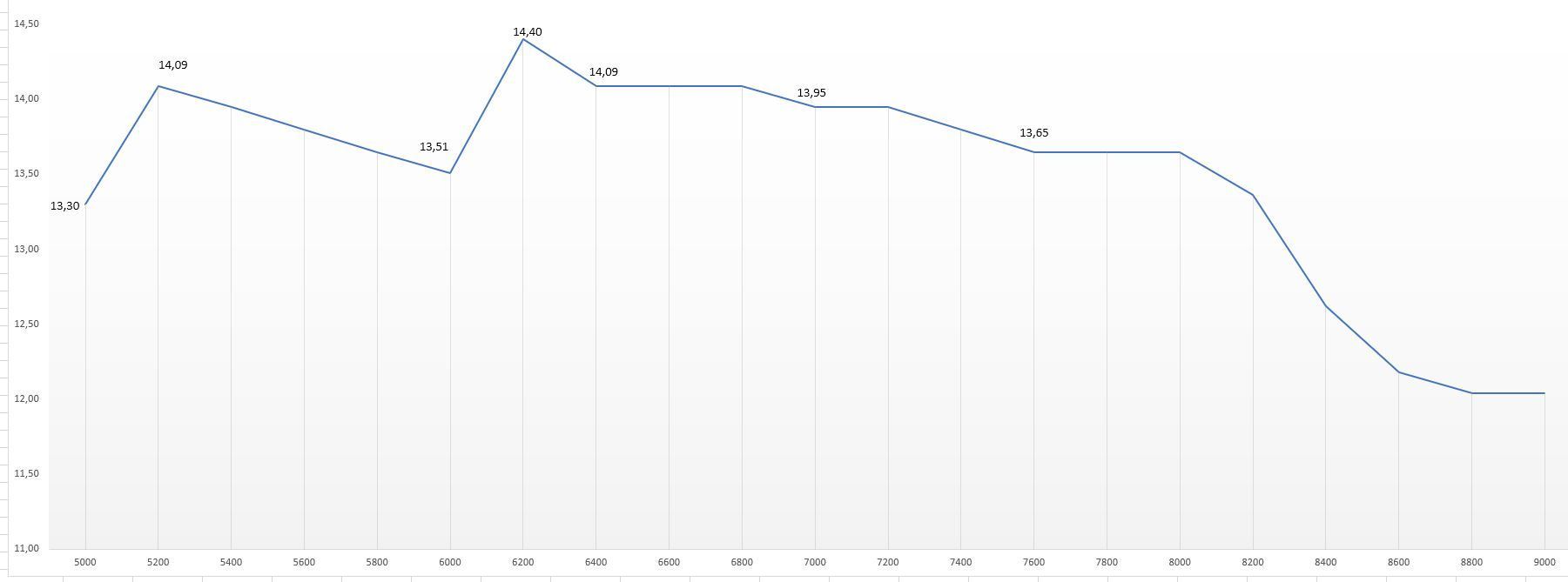

I will most likely start by going back to stock catalyst and see if that brings me back to a richer curve.
@flanders you already told me my AFR was fine. So that is another vote for leaving my 200 cat in the car
I converted all the values from lambda to AFR and put them into an excel diagram. I hope I read the original diagram correctly and didn't fail at converting. Too late here already lol.

Reading at the tailpipe location might be enough to make the small difference you are concerned about 12-13's are good for power, the small area of 14's isn't good for power but is still safe and perhaps with the reading error at the tailpipe you might be closer to 13s in that small area of the rpm band. Definitely not anything to worry about safety wise.
Old Apr 12, 2020 | 12:23 PM
EOE's Avatar
EOE
Joined: Aug 2006
Posts: 5,589
Likes: 69
From: New England
.92 LAMBDA is usually great with NA setup. You then gradually taper down to .85 LAMBDA and keeping you combustion temps nice and cool that way. I think all of this looks good other than 6200-7400 RPM area.
