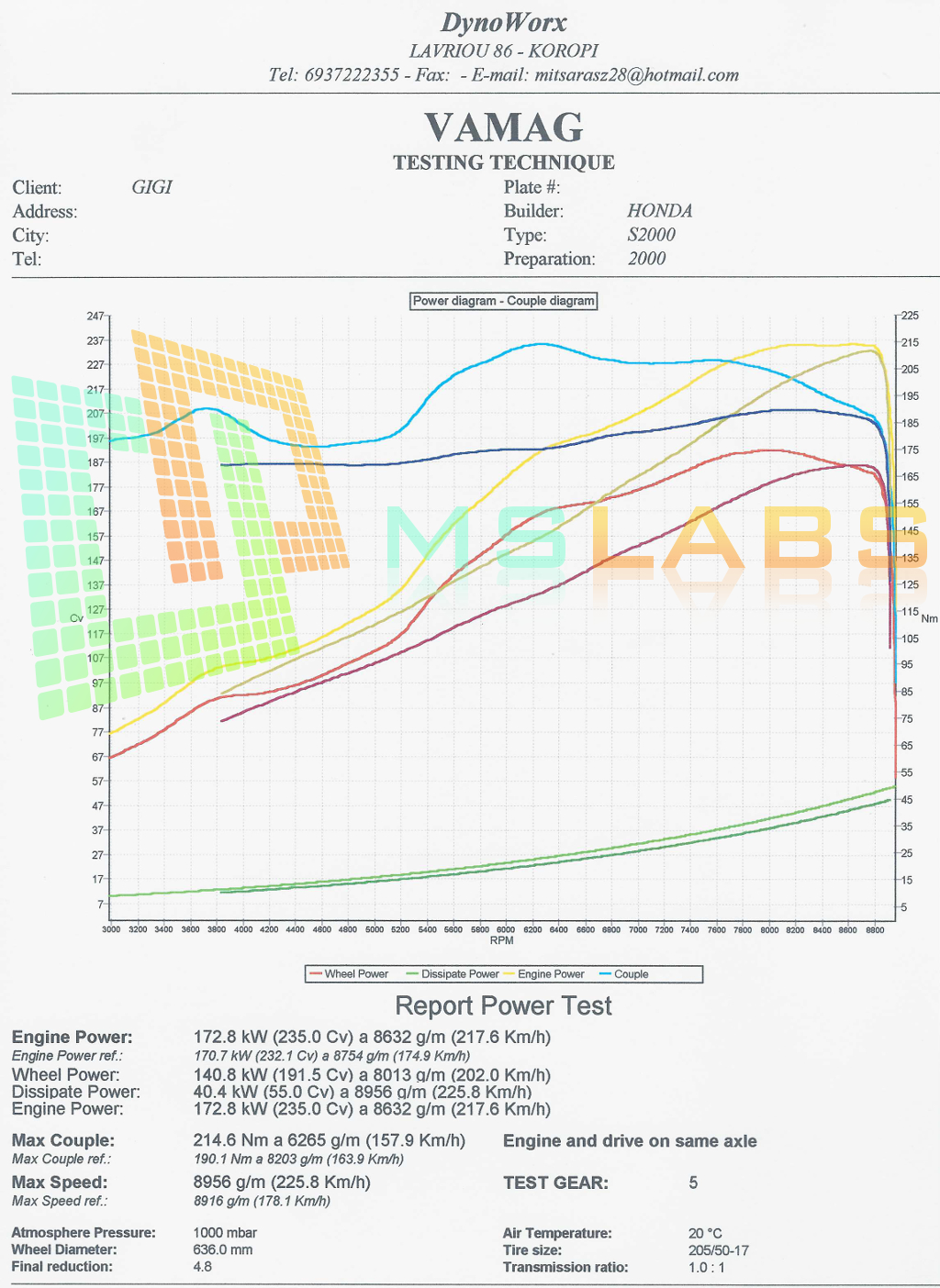

Results are in!
This car is a stock early AP2, with a 70mm exhaust, test pipe, and a glorified eBay cone filter.
With the stock ECU, it was running very lean all the way up to 8000rpm, 14-14.5:1.
I took care of the fueling, running about 12.5-12.6 up to 6000rpm, then 12.7-12.9 to the rev limiter.
I also added timing until it stopped making any more power.
Blue is torque (nm), yellow is horsepower, red is rear wheel horsepower.
The lower values are with the stock ECU, measured late 2014 IIRC, with this very same setup, even down to the same pair of (dyno-only!) wheels and tyres.
