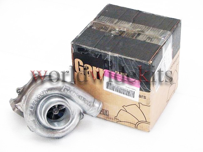

I know whats what I'm thinking, thats why I didn't understand why because one guy had a retainer failure it means you need to build your head or get crazy supporting mods.
I know you guys along with everyone else alive, minus dsmers, hate Godspeed turbo kits or any ebay turbo kit for that matter but I looked at the items and it seems kind of legit. They're using an actual Garrett and Rev Hard log manifold. Ebay IC's have proven themselves in many applications already and the DP and IC plumbing looks like its already been made to fit the S2k. Only things I'd probably replace on this kit are the ewg, bov, and lines/hoses and couplers.
What do you guys think? Seems like the ebay kits are starting to get less shitty as time goes on.
http://cgi.ebay.com/ebaymotors/S2000-AP1-A...=item45f09604e0
HMFIC has the Godspeed Turbo kit, you want to ask about that kit in everyday life, he is the guy to talk to.
In all honesty, the Godspeed kit is very very similar to my Ultimate Racing kit except it has less brand name parts.
