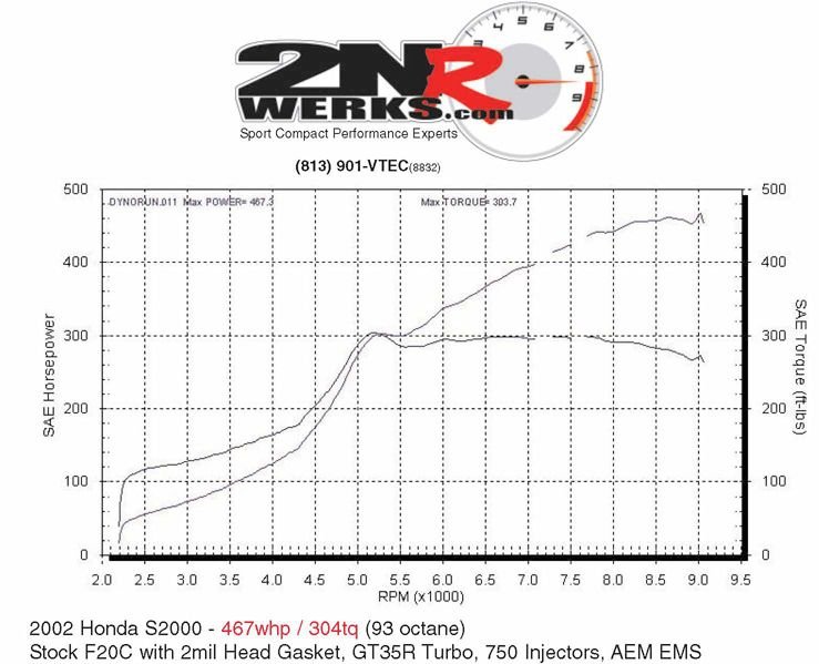

Every setup is differant. Exhaust flow, manifold design, turbo efficiantcy all plays a part in setting your VTEC. Here is a dyno from one of the cars I tuned. VTEC was set at 4200, after I added some timing in the 5000-5500 range the flat spot disapeared. This was at 14 psi on a GT1 kit. My car, which has an identical setup other than the manifold, falls on it's face if VTEC is set below 5700.
