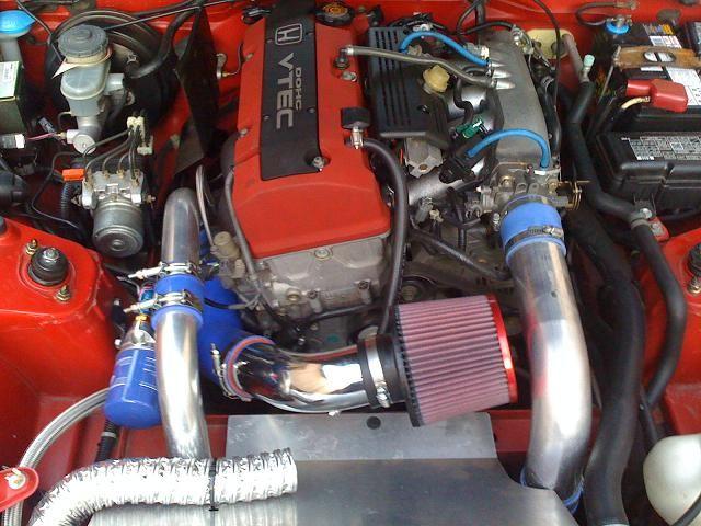

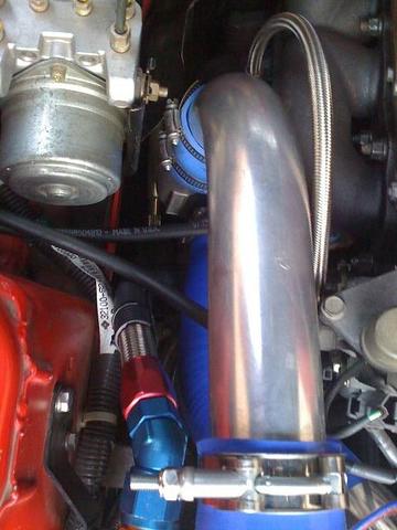

Lucky77, the turbo wasnt off the shelf. Its cartridge is from a gt3076r. Has a GT28 compressor housing which was bored out to accomodate the larger fan. Damn steering rack! Ive got about a 5-8mm gap from the rack. The GT28 compressor housing is about 10mm larger than the greddy from memory.
Joey, sounds awesome. With the tubular and GT30r with ext wastegate you should pull some nice numbers.
Sorry didnt take pics of when I had everything apart. Never really done anything like this but it was relatively easy as long as you take your time, look on this board for answers and ask the super helpful members. Here are some pics I took this morning, bit messy still need to clean the intake up, coolant lines etc. (I wasnt sure this was going to work so I made some tempory fittings) Looks almost identical to the greddy kit.
