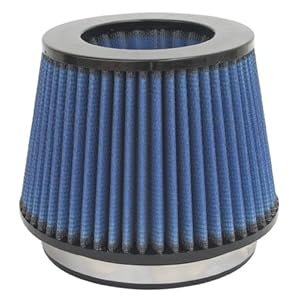

BTW I installed the K&N filter in to the CT Airbox. This K&N came out of my stock airbox. It feels like I lost some power! My only educated guess to why that is.... the stock Comptech filter uses Velocity stack design that is separated from the foam filter and re-used with the new one. The K&N filter does not use such design.
The Foam that it came with was literally falling apart so when I took it off I just trashed it. Should I replace this K&N with the CT Engineering's NEW foam filter and start using the velocity stack adapter to gain the power? Or do these not filter as well?
http://www.ct-engine...roduct1563.html
OR K&N RT-1048 That will re-use the Velocity Stack.
OR APEXi 500-A024 which has 140mm (5.5") inlet as well... Not sure if it'll be as plug and play as the ones above...
Edit: Never mind no Apexi filter will work with the Velocity stack.
or AFE
20-91030
So basically at this point I need to find a filter that has a 5.5" or 140mm "Filter Inlet" size and Length that shouldn't be more than 7". AEM nor APEXi carry such sizing. I'll keep looking.

This is the filter then several of us use to replace the stock CT foam filter. The foam filters flow better then anything, but they also don't filter very well, so the next best option is a cotton washable filter like KN or AFE. I thought I noticed a slight power loss when i switched to the AFE, but who knows. I have piece of mind that I have proper filtration now.
http://www.amazon.com/aFe-24-91021-U...785099&sr=8-12
^^^ I'm not sure if this one has the correct size opening or not. You need to research before ordering if you do.

The one I posted is 5" long, the one you suggested is 6" long. I guess it doesn't really matter at this point which one I get. Maybe 5" is better so the filter isnt crammed in the box? If that even matters.
