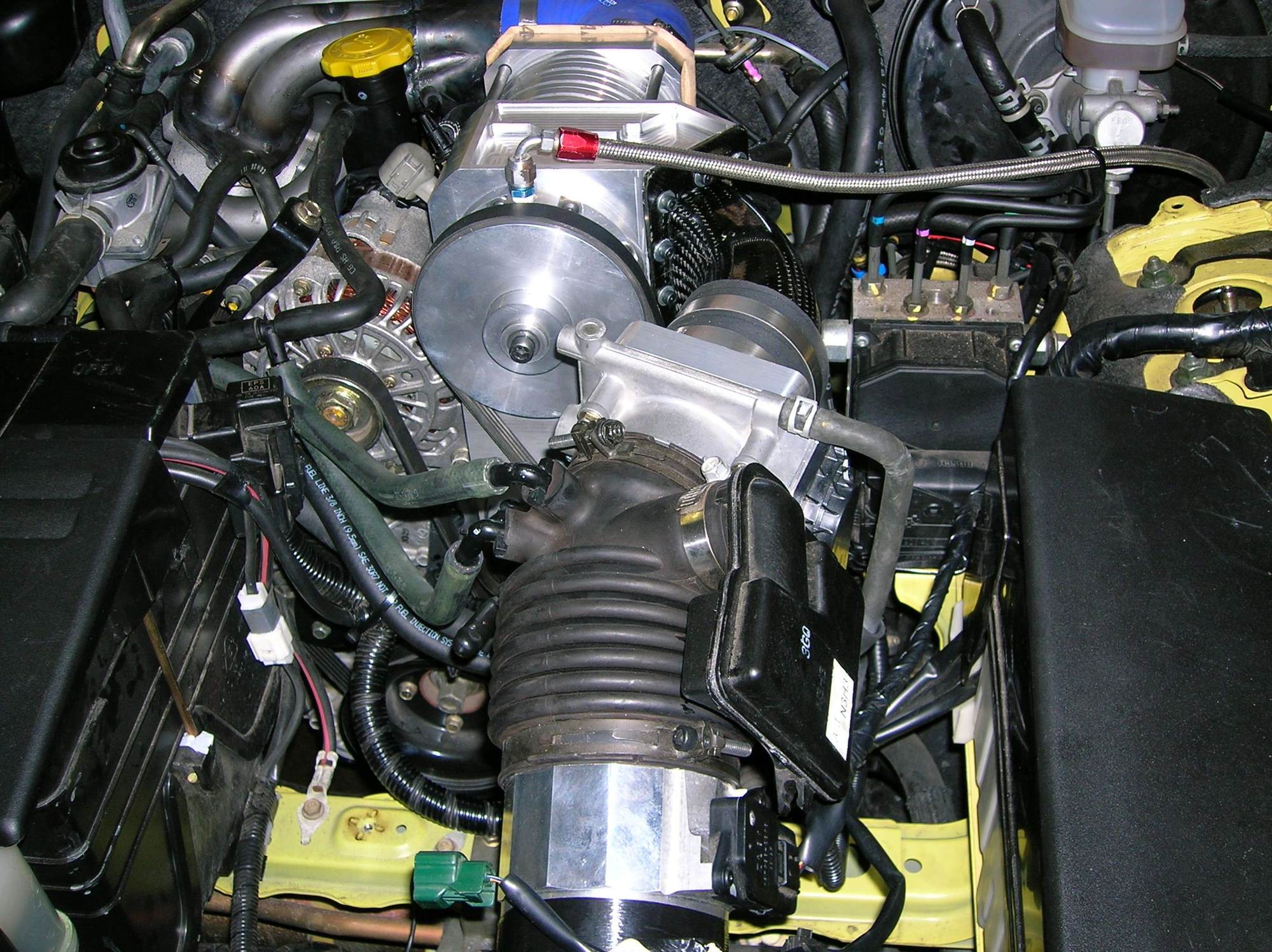

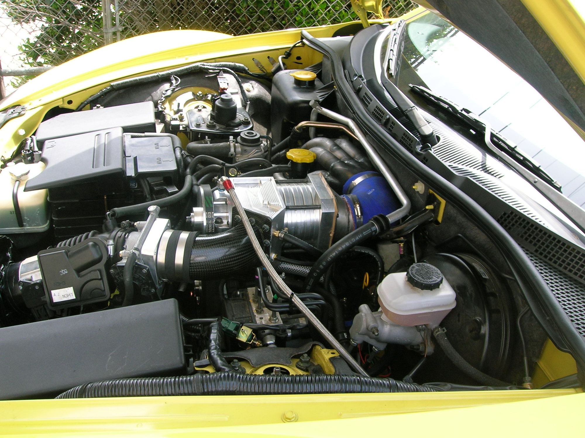

A major update for everyone RP has got the Blower installed and up and running on the RX-8.
PR is holding the boost down to 2-3 psi(by way of an over sized pulley) since the electronic have not been finalized yet and there has not been any problems what so ever so far.
There are no drivability problems; It idles perfectly and has no ill effects on any normal driving.
You cannot hear it unless you open the throttle and then it is only a slight whine.
If you know its there and listen for it you can hear it standing next to it.
BTW it took about 12 hours to do the first install. Which once the production parts are available it should only take a first timer about 8 hrs. Note this was the RX-8 install The s2000 install should be somewhere in the same time frame.
Picture album won

Here's a picture of the Rx8 install. I'll get you a couple more. Just that the S2k is that much closer to getting under way.

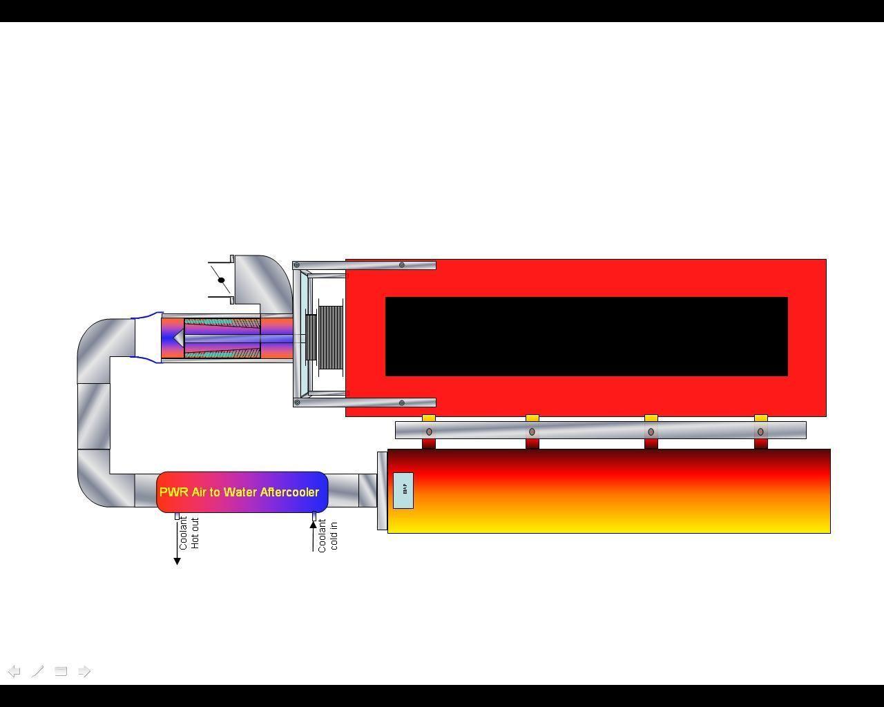

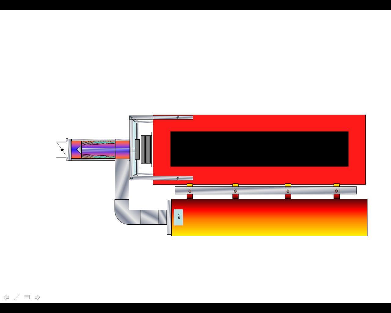

Got another idea for the S2k AFSC very simple.
Two design ideas now the A/W Aftercooler is not necessary but if it is a possibility it would be nice to have one just to get a bit more power due to cooler denser(more mass flow) air charge
After cooler setup would require a reverse flow design from the non after cooled version depends on how big the Aftercooler would need to be.
If the cooler was small enough it would be possible to replace some of the piping in the first picture with the Aftercooler.
