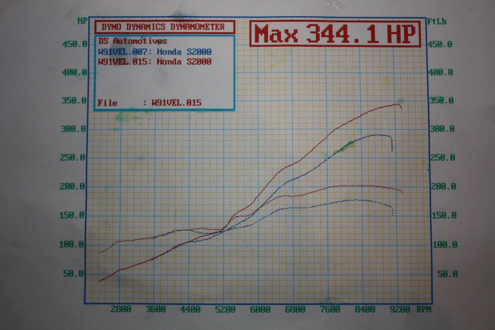

hi guys,
anyone have any ideas where i should start with regard to my boost loss or running uber rich, the car was professionally tuned a while back (couple of weeks ago) and when out driving hard the car went all of a sudden from zippy to chug chug chug chug etc - it pops and bangs when on throttle but is fine on partial or cruise. I dont have a wideband so is there anything that i can check before going back to the dyno?
Belt slip seems obvious but I have swapped the belt from a dayco 39" to a gates 38.5" already and it makes no difference.
Loose o2 sensor, loose wire on aem?
Any ideas gratefully recieved!
Thanks
Dave
750 rc injectors
10psi pulley
ctsc with ac
30-1052 aem
test pipe
mini krankvents
singe exit 5zigen
hondata 4 bar map sensor
jdm cr!!!! -1mm HG!
red is /was my new figures, blue is the old ap2 pulley.
