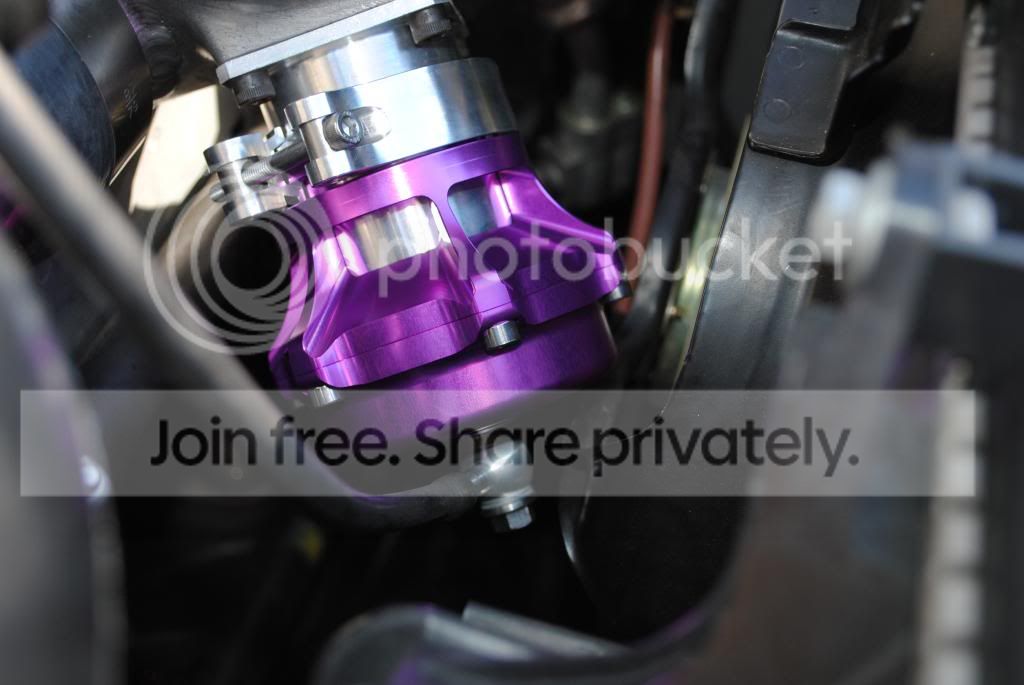

Welp, got #2 finished and shipped it off to starrman. Came out even better than the first I think.
I guess if anyone else wants one that has a Comptech kit, send me a PM and I will see about making another one. Mine is still holding great and shows no signs of contacting the radiator fan shroud.
Price will be $100 shipped/PayPal'd, and lead time will be approximately 2 weeks. I will only take on one at a time.

lol...yeah, the recirculating bottom half is so quiet that i sorta miss the hissing and snarling...i'm going to put back the atmospheric bottom piece on my BOV when i install this badass piece that i got from some CoolGuy named Andy.
the adapter is a work of art. got it in the mail today and now i need to get a viton 50mm o-ring before i install it.
Thanks Andy!!!

Got mine installed today, no issues with the fan shroud...plenty of clearance. I will get some pics tomorrow and post them up.

Awesome!!! So glad this worked out so well and that I could get a few out there to people in need!
And for everyone who got one... you will reuse the o-ring from the old Comptech flange that goes between the flange and the aftercooler, and you will use the o-ring that came with your Tial between the flange and the Tial BOV. Be sure to use both of those o-rings to prevent any boost leaks.

Installed yesterday and tested out today, the flange is a work of art! It is so much higher quality than the flange that came with the Tial. The sound is certainly different, and will take a bit of getting used too, it is obvious that this setup allows more air to escape than the Bosch diverter...so along with that comes a bit more noise of air rushing out. I should add that my hood is vented, so I hear things that most people do not. So now I have a symphony going on under my hood...the rattle of the SC, the whistle and now a pshhh...pretty cool, drove by a local garage that usually has imports out front and let it pshhh as I went by...every head turned lol.
