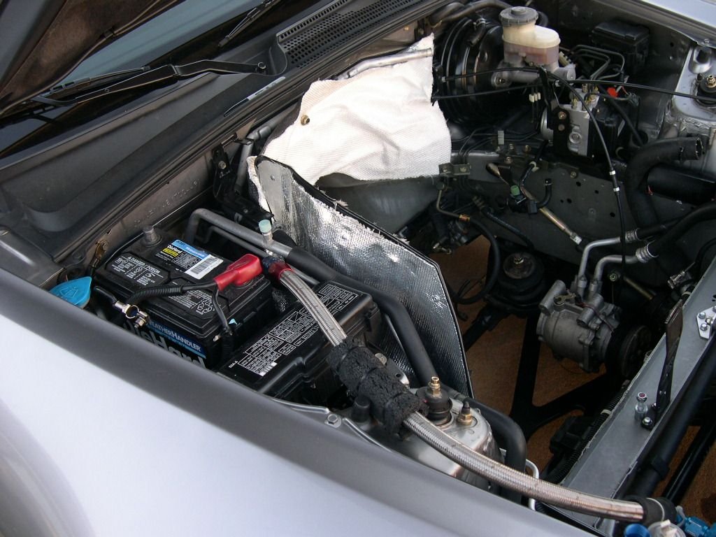

Here's some underhood fiberglass insulation for a Speedcraft car (low mounted turbo) The OEM heatsheild was covered on both sides, and makes quite a difference in temps on both side of the sheild.
