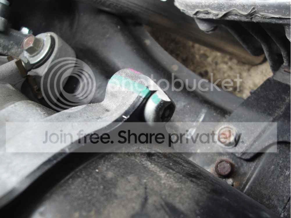

From my exchange with Kraftwerks:
"You will also have to shave the close piece from the steering rack as the new crank pulley becomes very close and under extreme braking conditions, can make contact.
This modification is required by even TTS in their instructions and will not cause any damage provided you use the attached image for reference."
Correct... My TTS picture for reference... https://www.s2ki.com/forums/index.ph...age&img=845150
