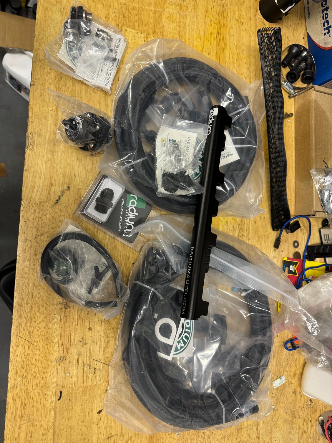

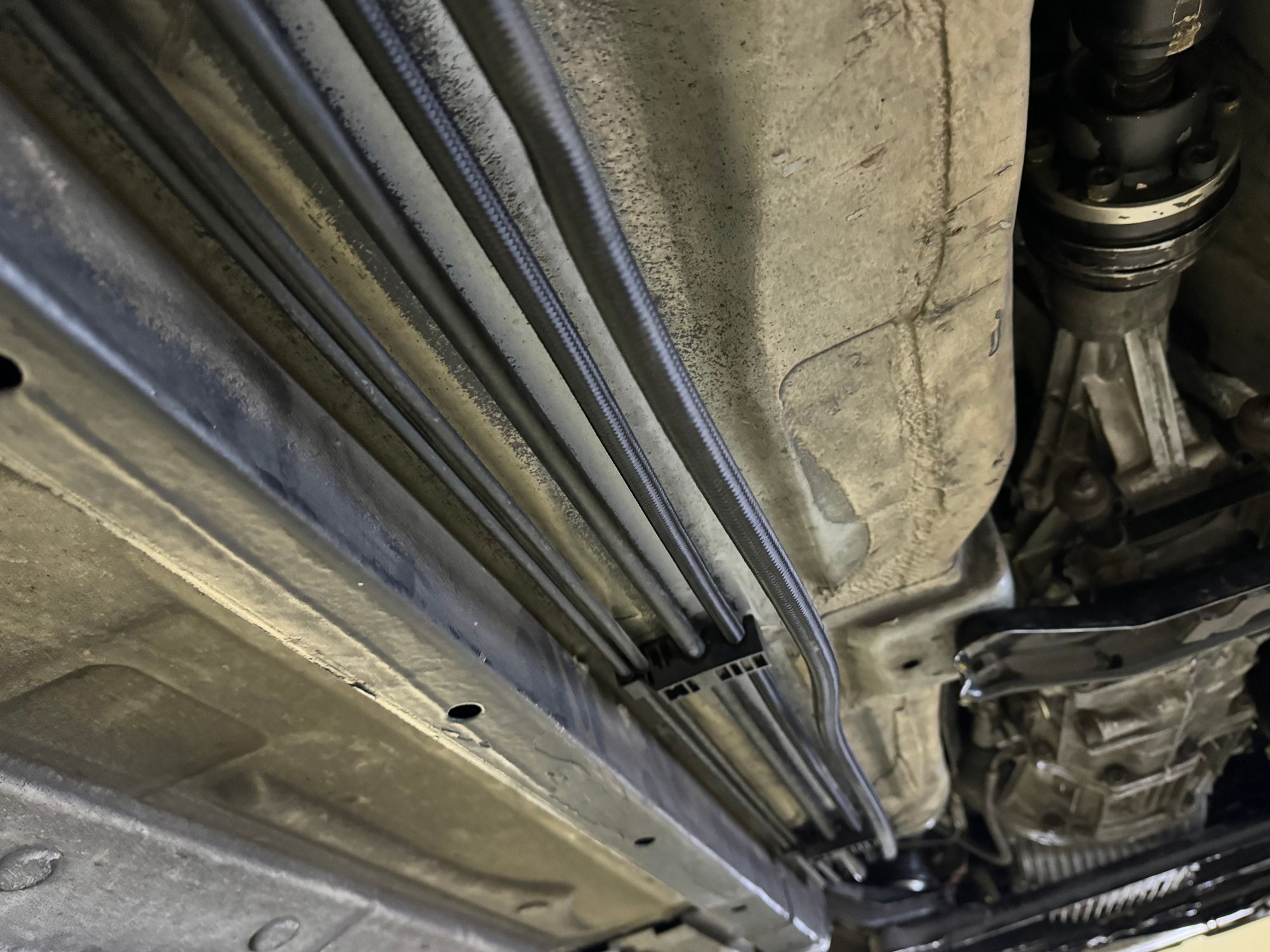

This weekends progress:
Old Jan 7, 2024 | 11:48 AM
  #79
Dizings2k's Avatar
Posts: 2,140
Likes: 162
From: Johnstown, PA
Old Jan 7, 2024 | 12:00 PM
  #80
Dizings2k's Avatar
Posts: 2,140
Likes: 162
From: Johnstown, PA

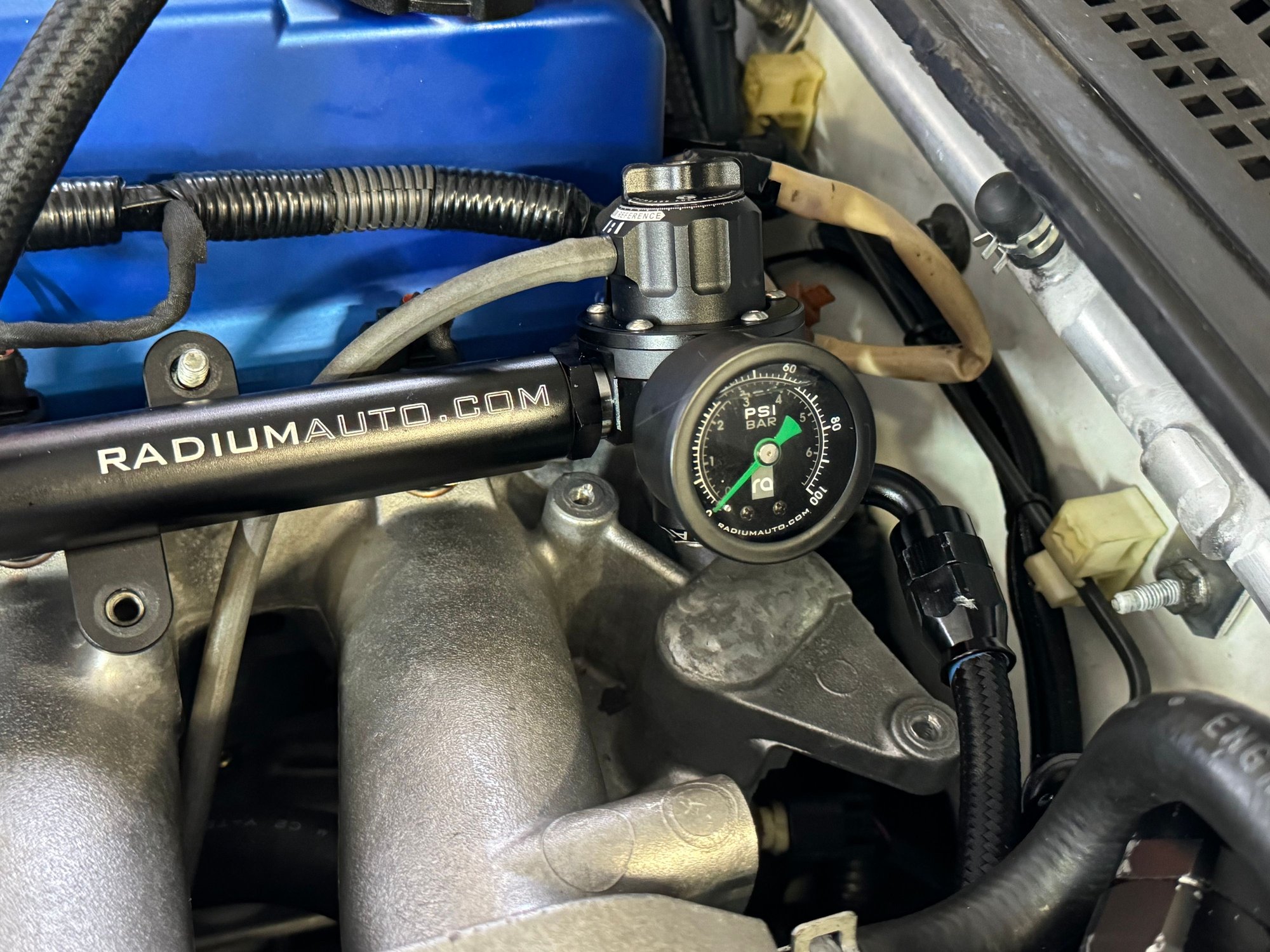

Couple things to button up yet:
I need another fitting for the fuel rail feed. I had a 90 deg AN fitting but it touches the intake manifold bolt head, so I ordered a 120 degree fitting and a radium banjo fitting. The banjo will definitely work but we’ll see
if a 120 AN does.
I need to secure the 8an fuel feed line under the car
somehow. I still have the evap system and will stay that way for now, I’m not getting into the removal of it right now.
I think I’m going to clamp the feed line to the return line with the AN brackets you can buy. I’ll clamp them next to where the return line secures to the plastic carriers, I think it should keep it in place. I will probably also get some of those clamps with the self tapping screw deals to secure it in other areas.

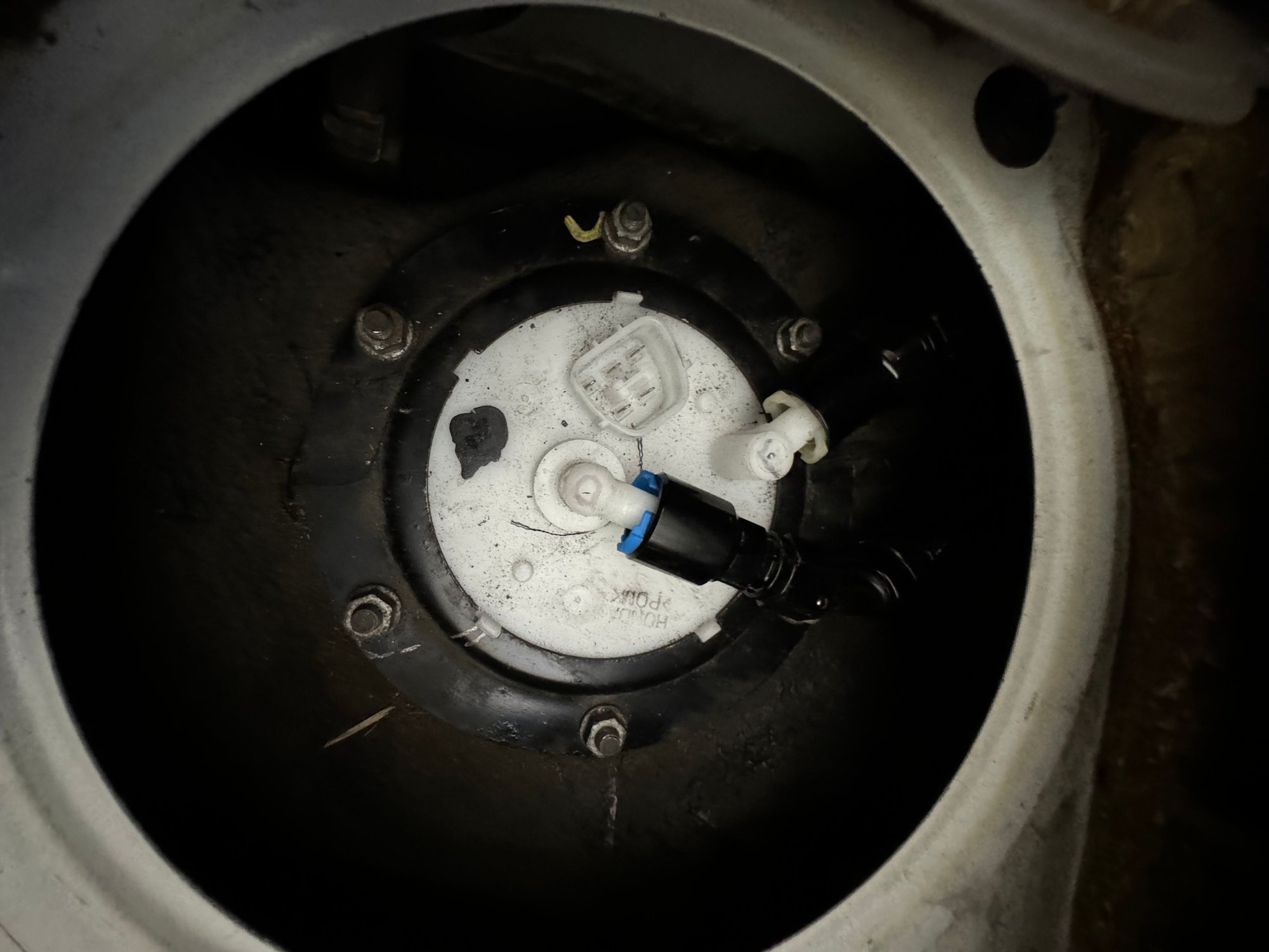

The fuel hanger wasn’t bad, but getting those lines connected to the fittings at the top, whew that was a real pain but it’s done. It really sucks working half in the trunk and half head sideways jammed under the soft top.
The vacuum lines are another area I feel could be improved. I have so many Ts now with needing to feed the FPR, pulse damper, bpv and boost gauge into the intake manifold.
Otherwise, soon as I get that last fitting, she’s ready to fire up and set base pressure.
