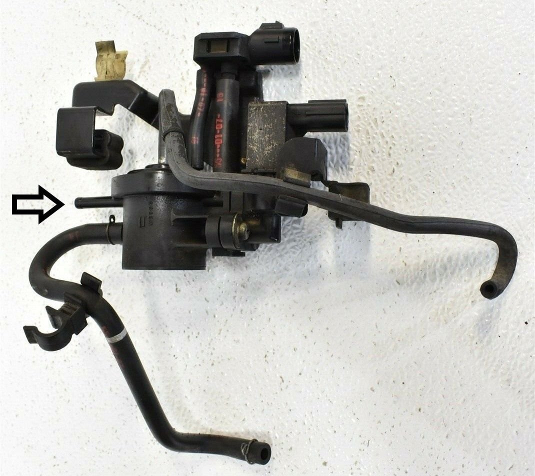

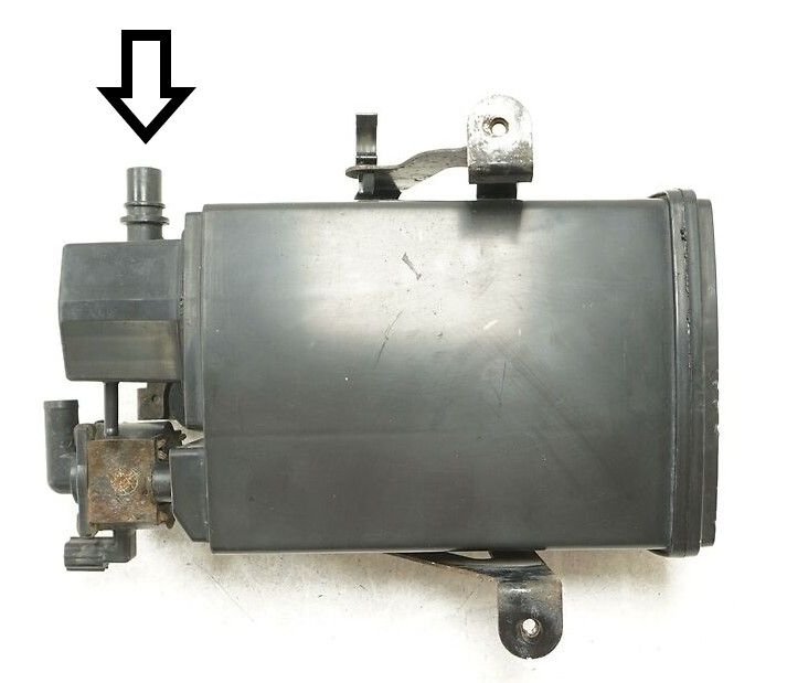

Can you post pictures when you cap off these hoses? I also need a way to go back to stock for emissions testing and don’t want to rip out the whole Evap systems. Thanks!

To circumvent the entirety of the system all you'd need to do is remove the fuel tank vent hose from the 2 way vent solenoid (it's the only hose held on with a spring clamp vs the skinny clips) and put the valve on the end of that. Also remove the breather hose from the charcoal canister (The one that's a squeeze-lock fitting on a plastic corrugated hose) Both hoses are pictured in my DIY so you can see what they look like. Here's a pic(s) of where you'll be removing both lines:
Cap the solenoid nipple with a 1/4" vacuum cap, the one on the charcoal canister is roughly a .600 OD, I'm sure a 1/2 or 5/8 cap will fit. I'd go 1/2" for a snug fit. Leave the breather hose open or put a filter on the end of it.
