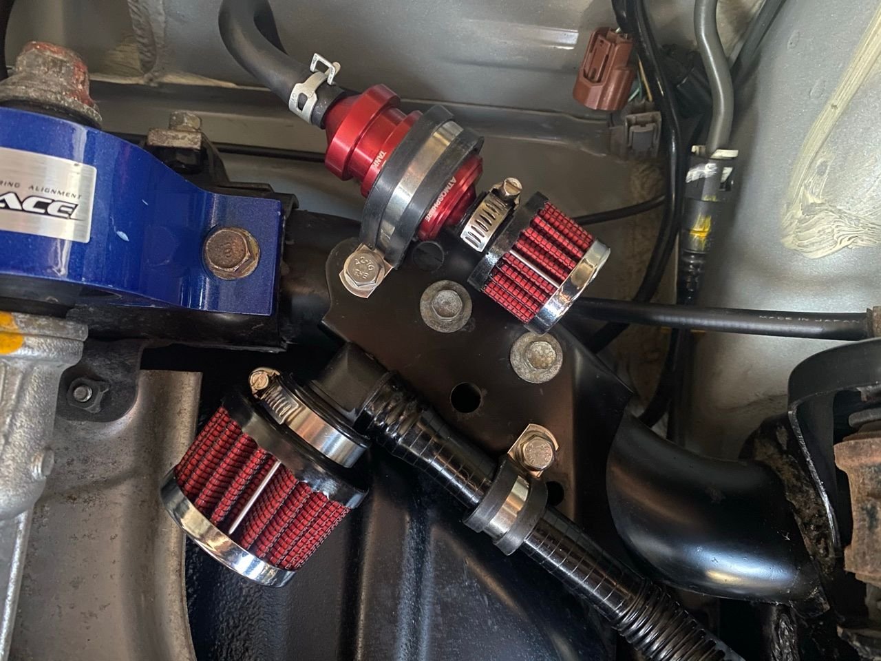

Found a filter that worked for the breather hose. K&N 62-1370, 1" flange ID. Fits around the plastic shell end of the breather hose snugly, now you can rest assured that nothing will be ingested into the tank.

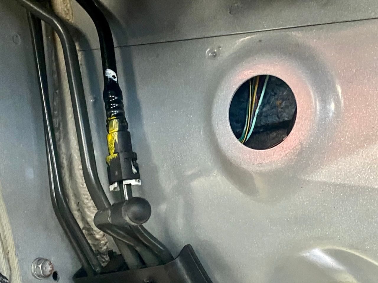

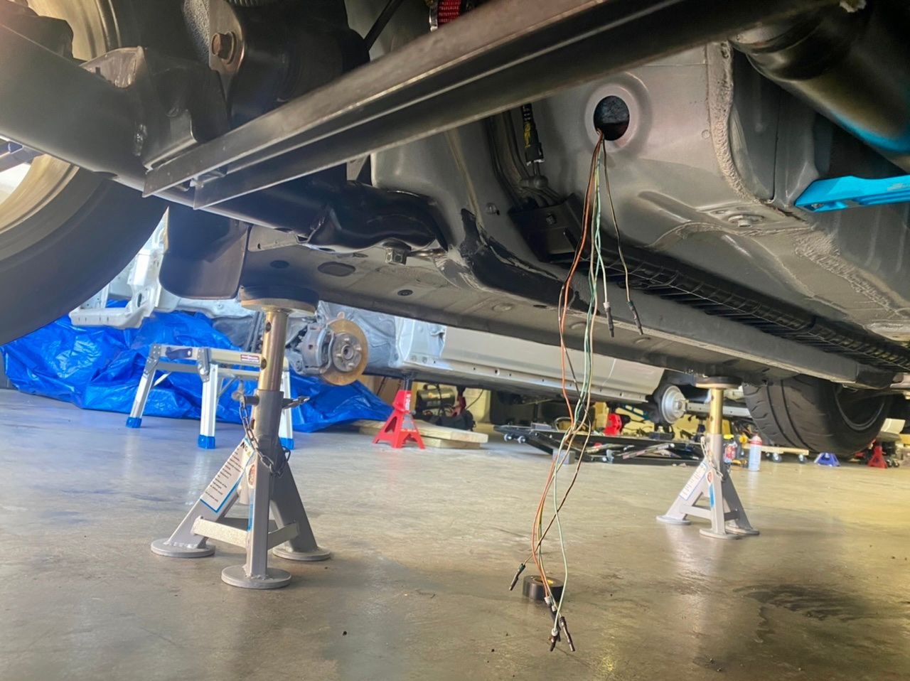

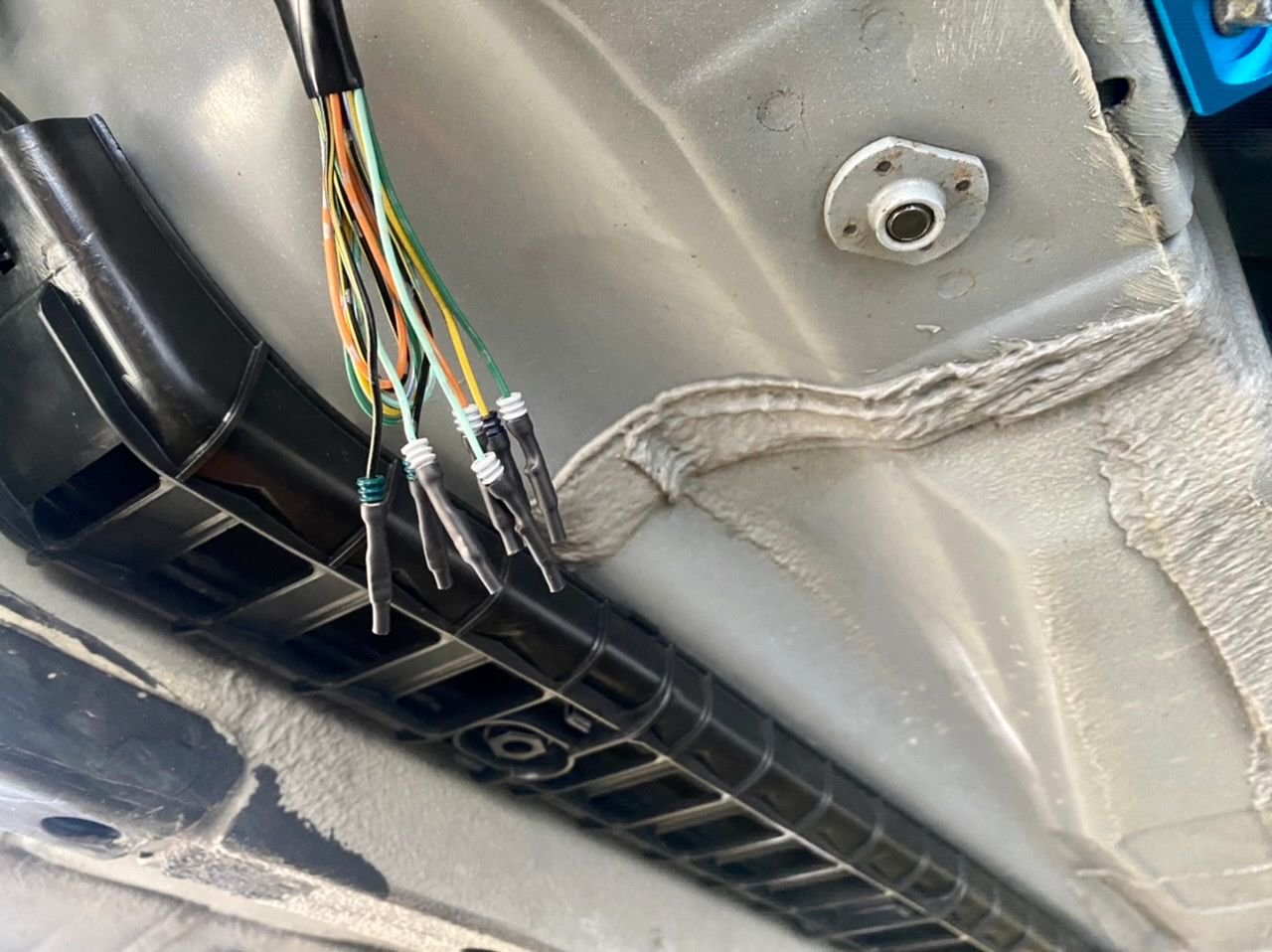

Okay, here's my last addition(s) to this thread for a "comprehensive" removal of the evap system. Will be updating the OP post as well. All of this is optional, but I typically like to see things fully through until I'm satisfied, so if anyone else would like to do any of this, I've blazed the trail for you.
I wasn't happy with just leaving the leftover wiring for the various evap components at the rear of the car just zip-tied out of the way. I ended up unwrapping everything, de-pinning the connectors to remove the wires from the factory grommet without destroying it, putting shrink tubing over the pins, bundling the wires up and inserting them back into the body of the car. I then used a blanking grommet for the 1.5" ID hole in the body for a clean finish. Didn't see the need to put the connector shells back on the wires; only if I was re-installing the system would I bother, and even then in order to get the factory grommet back on you'd need to have the wires de-pinned anyway so....

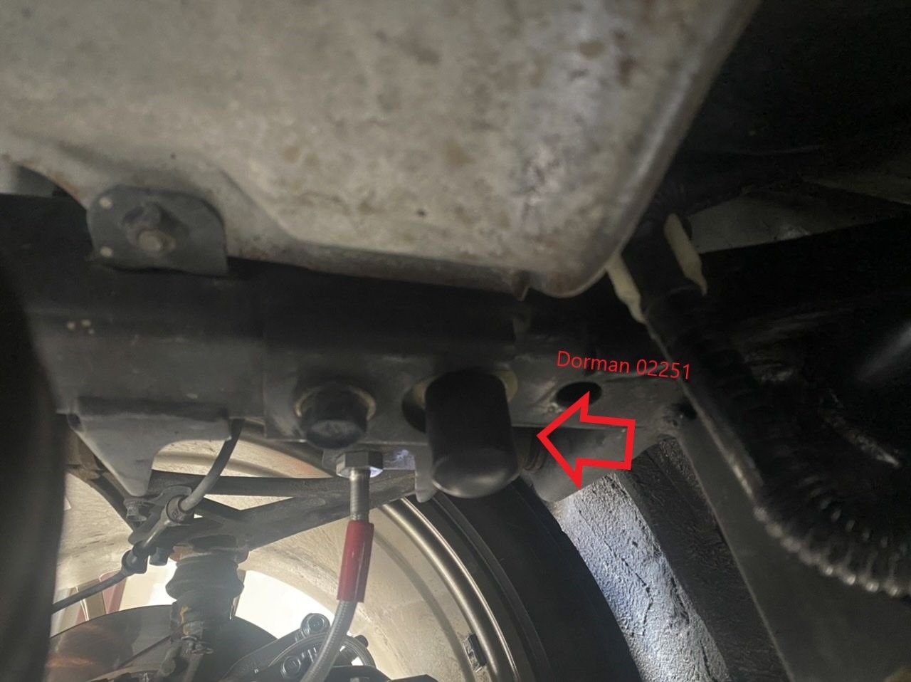

Lastly I capped off the "drain" nipple on the subframe that connects via hose to the evap canister. This isn't necessarily a drain at all, but instead where the excess built-up pressure is vented or "drained" to from the canister itself. Realistically there's no way to "drain" liquid upwards, because that's how the rubber hose connecting to it is oriented. Also, if any moisture needed to be drained from the subframe, it would come out of the hole immediately adjacent. Again, not necessary, but a nice finishing touch.
For that I used a coolant bypass cap, Dorman P/N 02251.
Amazon Amazon
Advertised as 3/4", but the ID is .690, so it fits snugly around the .700" OD of the drain nipple.

@gnehc1 It was much to difficult to leave everything in there and try to clamp things off. However, ripping everything out and installing the valve was dead-nuts easy. I do need to go back and add the same foam+ziptie to the other corrugated breather hose. When I first disconnected the last line that went to the gas tank, massive hissing because my tank was pressurized! When I took off almost every other EVAP component, I got sprayed with liquid gasoline. My EVAP system was filled with fuel everywhere.
