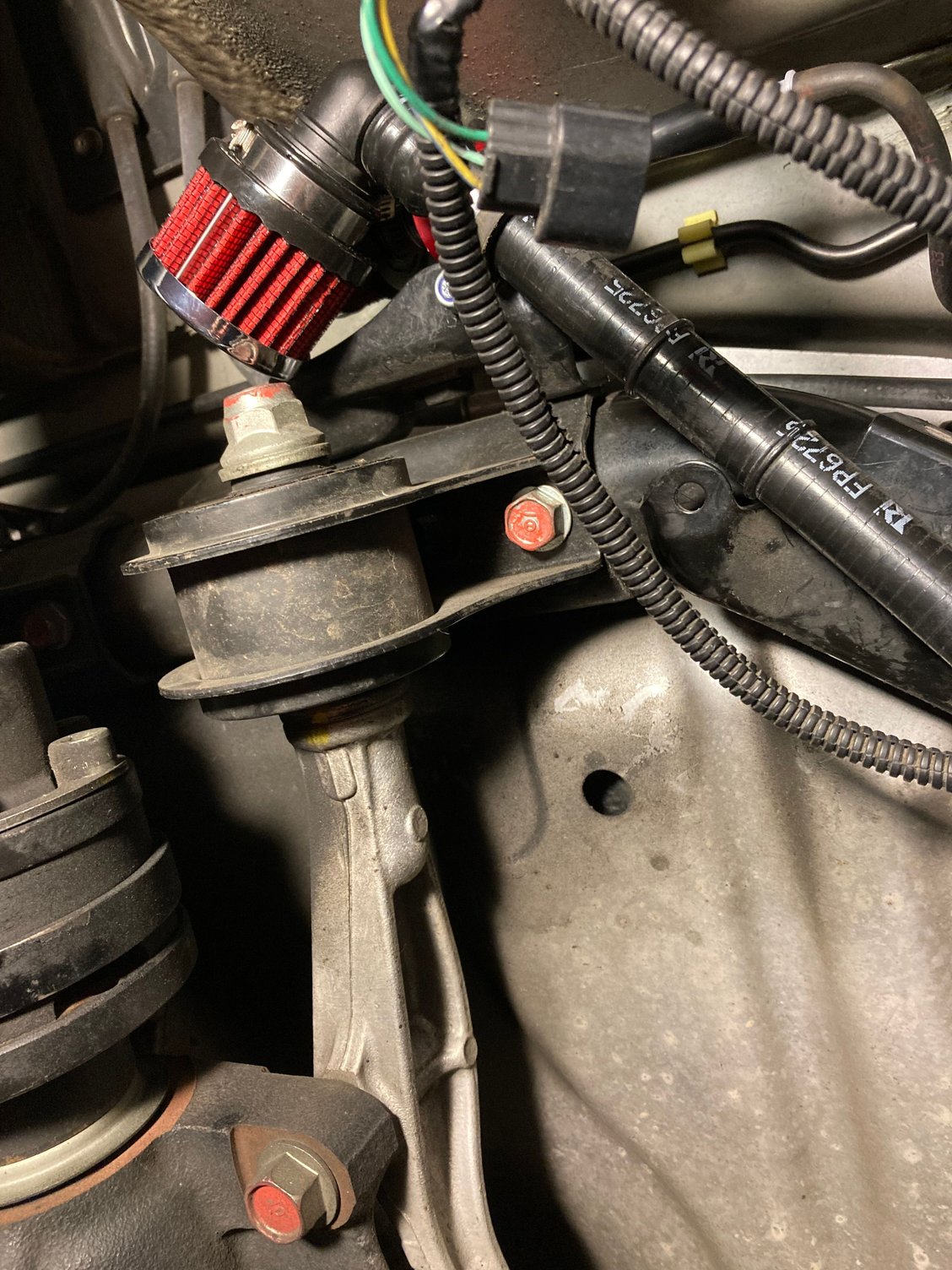

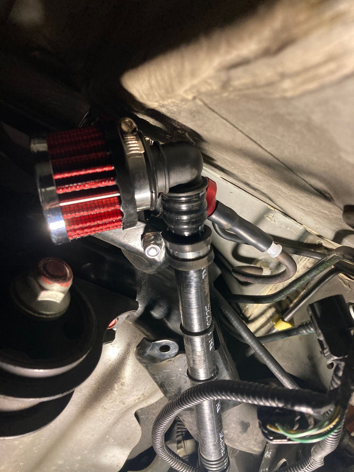

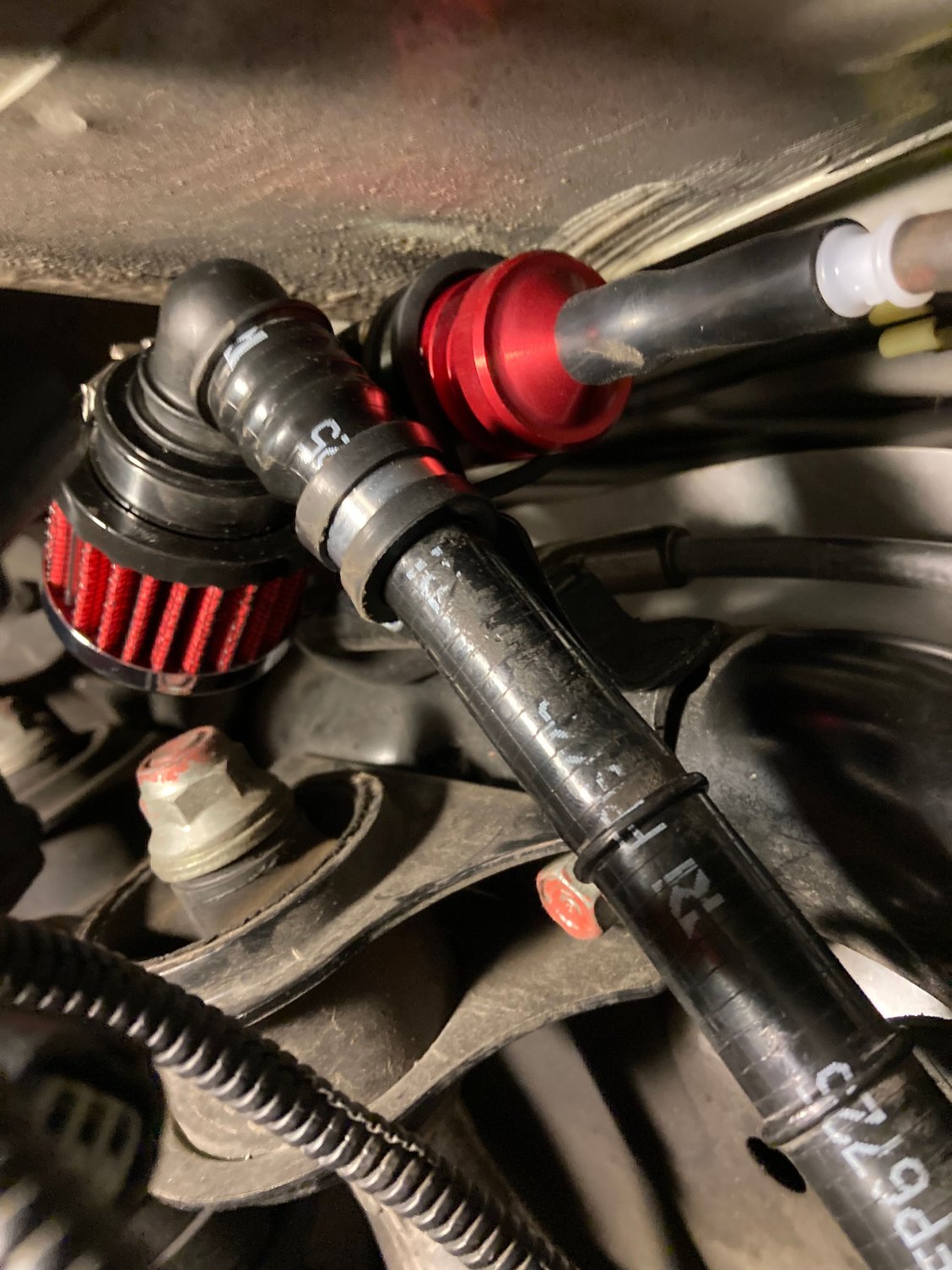

I just got around to finishing this mod myself--once again thanks to the community for coming through! I surely would have ended up with a flooded canister if I hadn't chanced upon this thread. Now as it turns out, things are laid out quite differently in my 2007. Here is how I tackled my delete:
First of all, I have no idea how anyone is able to fit K&N 62-1370 over the top of the air intake hose. I tried copious amounts of lube but eventually just said eff it and cracked out the Dremel.
Here's a shot of the final product using the same cushion clamps as the OP along with a single 6x20mm bolt and locknut.

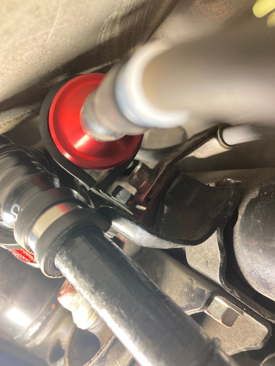

Here's a terrible shot for ya.

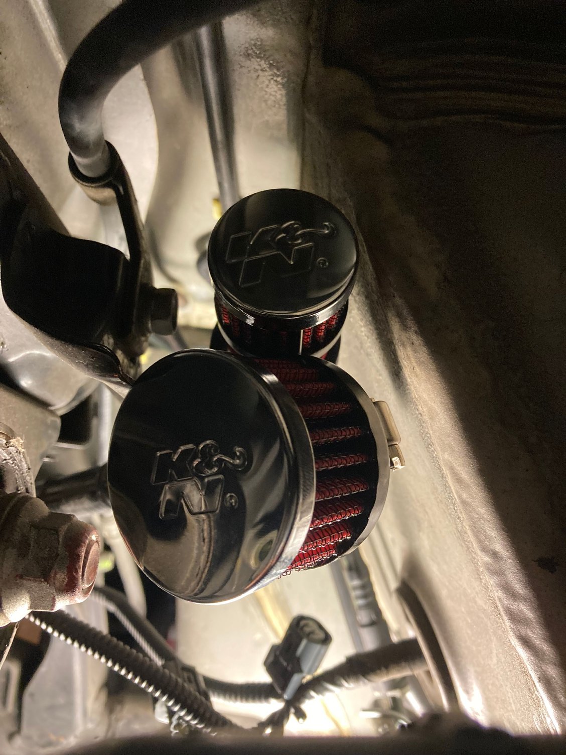

Yeah the filters are right next to each other but it's too damn tidy to muss.

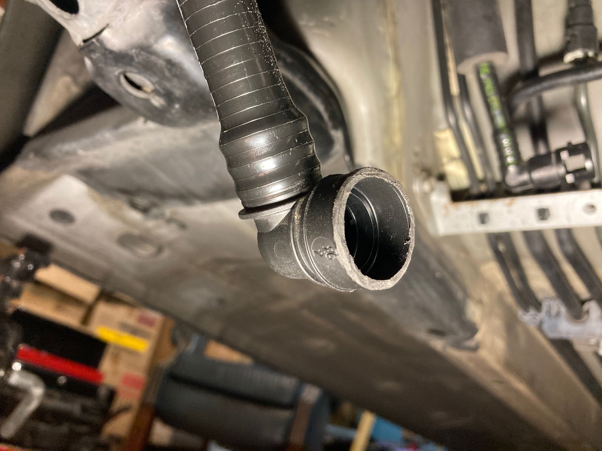

This one's for you @spaded.racer
The hard line is still there as a structural member for my DIY AP2 return-style fuel system. At least that's the excuse I tell myself for not removing it. I'd like to deal with the electrical connectors too but I've had enough for now.
Enjoy!
