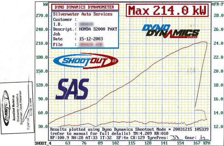

No they shouldn't. If I had that wrong I doubt it would even start. As it is, it makes 214Kw at the wheels.

  #184
AusS2000's Avatar
Posts: 30,809
Likes: 15
From: Sydney
