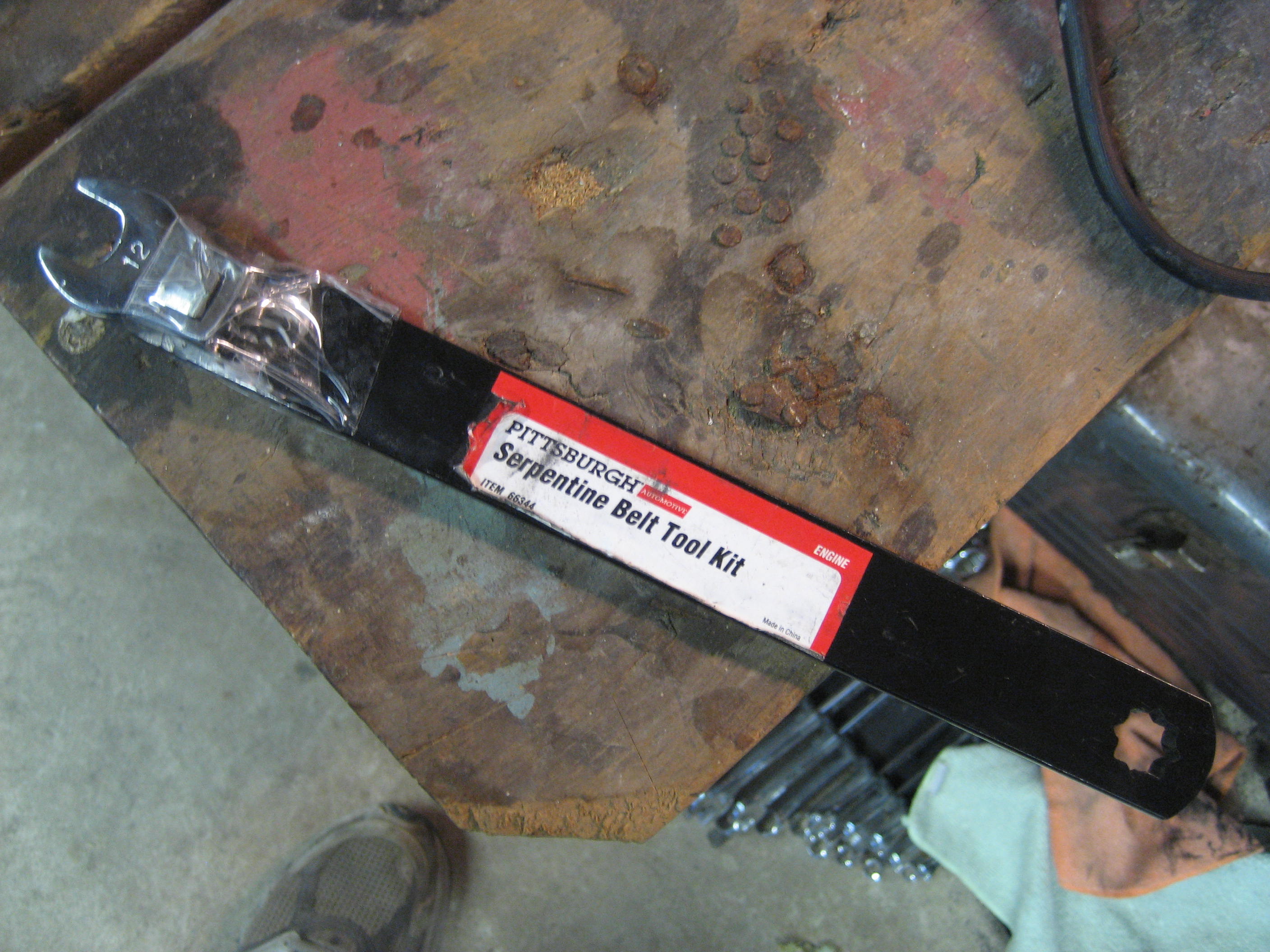

Homemade exhaust manifold nut torque adaptor
[attachment=24670:IMG_6834.JPG]
[attachment=24672:IMG_6871.JPG]

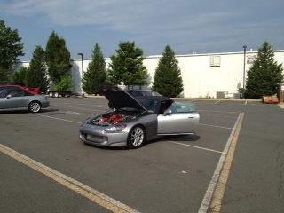

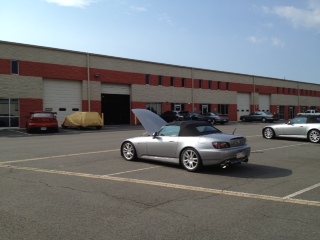

So this past saturday I trailered my car down to PTuning to have Toan tune my car. I do appreciate that he took his time out to talk to me in detail about my set up and what I was specifically looking for with my tune. He was happy to explain any questions and or concerns that I had.
After numerous hours of work and countless numbers of dyno pulls a problem arose which was Hondata's fault. Apparently in one of Hondata's updates to their Kmanager software, there seems to be a bug in the knock control which kept pulling timing. Toan needed to contact Hondata so that he could properly tune my set up. As this was on saturday Hondata was closed so I had to leave my car there. We are shooting for this coming thursday for me to go down to pick my car up. I can't wait to see what kind of HP and torque numbers Toan can produce.
[attachment=24698:PTuning 1.jpg]
[attachment=24699:PTuning 2.jpg]
[attachment=24700:PTuning 3.jpg]
