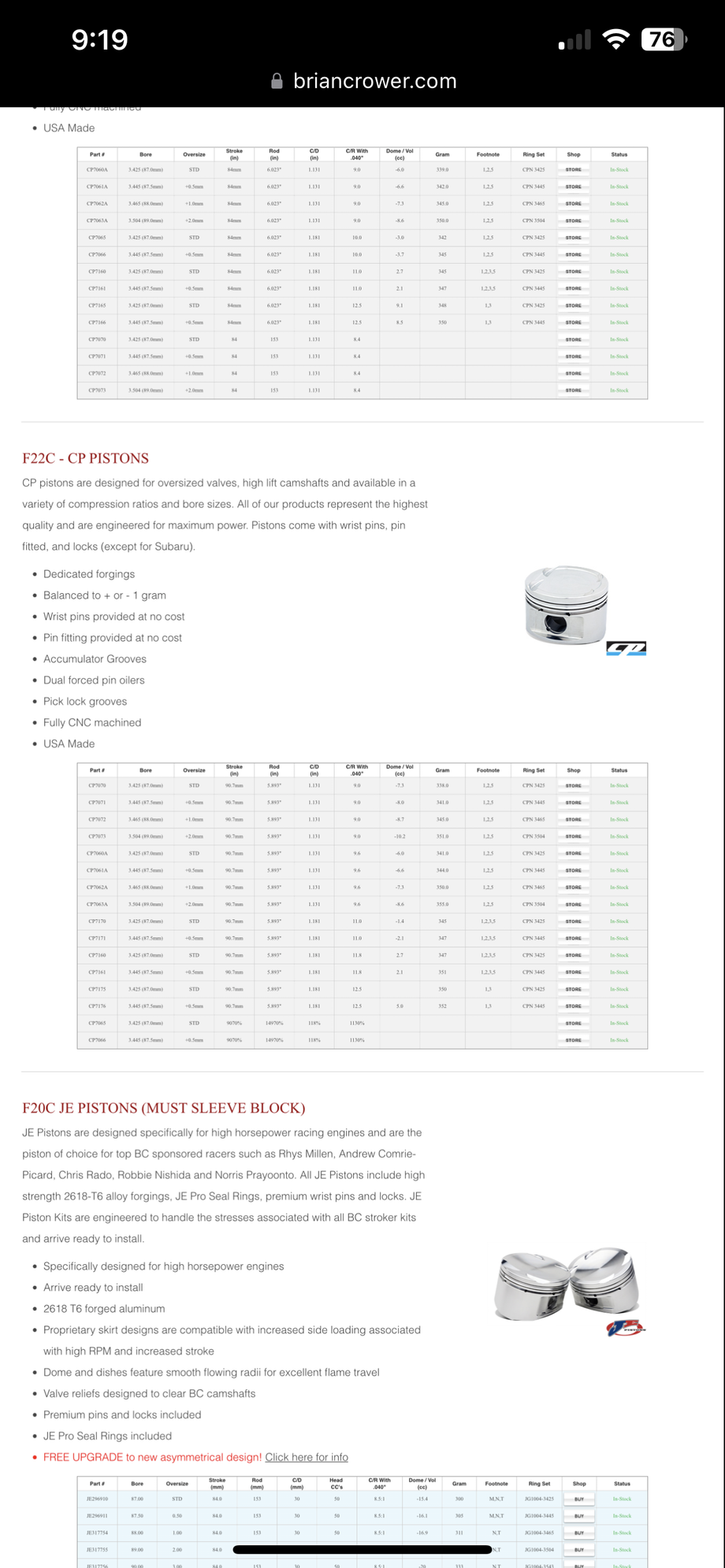

CP has some options

yep I was thinking aftermarket. Should be options out there I would think to get oversized ones.
