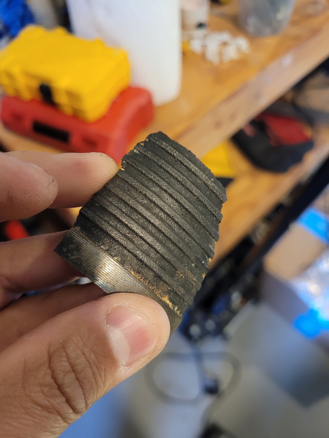

I'm also not a big fan of sleeved engines as I've seen my share of issues with sleeved blocks years ago. A big one being they sink/shift and even leak coolant (where the new sleeve rests on top of the old sleeve that got cut down, water seeps between the sleeve and Al sleeve that's left). With the old honda motors the steel sleeve was cast into the Al sleeve/block with ribs up and down the bore. I'm not a ME but that would seem to be stronger than sleeves pressed into place.
Here's a sleeve from an old b-motor.
