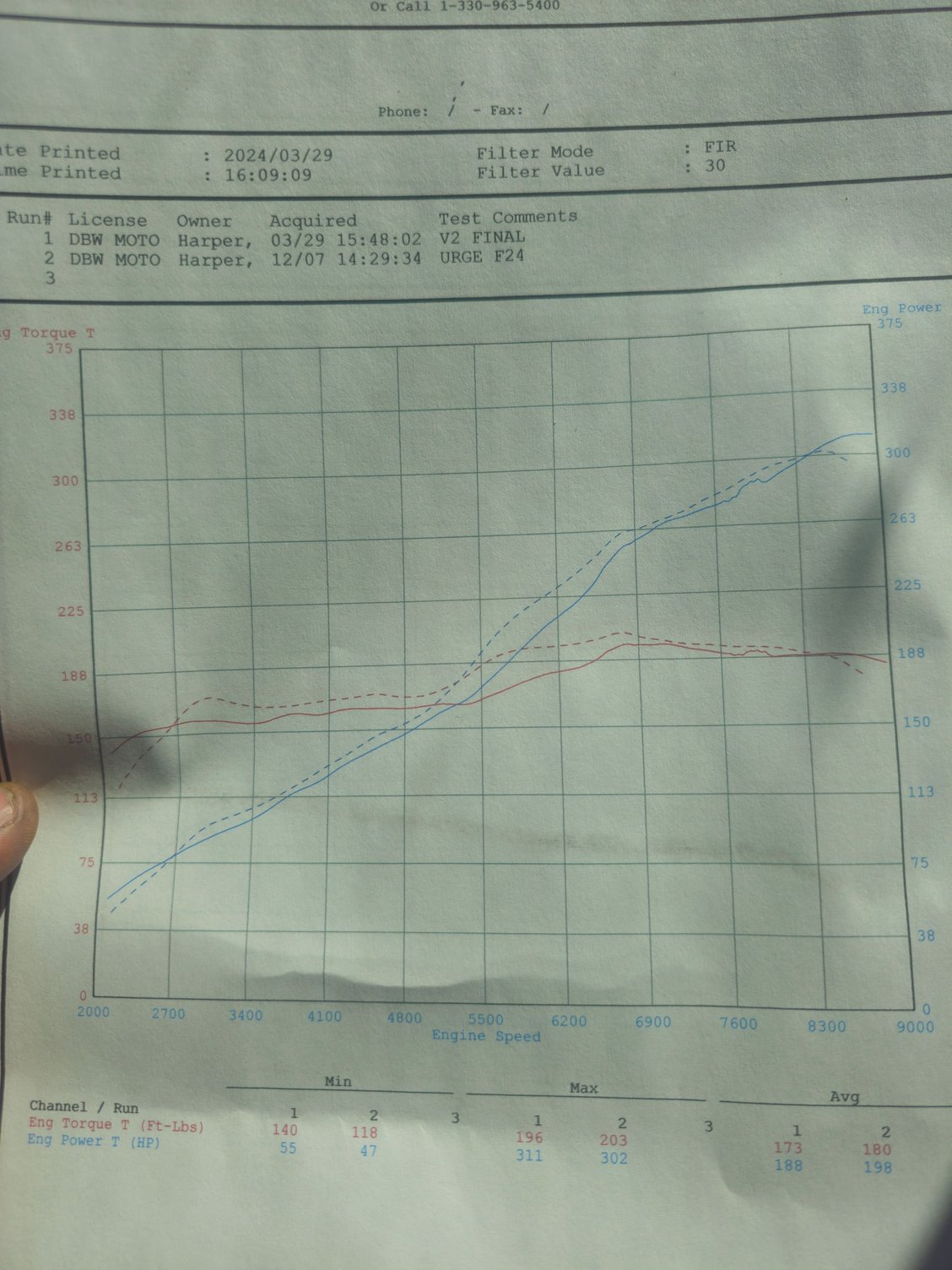

I can't speak to that. I started working with Urge a little over a year ago on the development of the engine that is currenly offered on his site.
The solid line is what was achieved with the street spec engine. The dotted line is higher compression. This dyno was a little while ago. We are currently sitting at 304/210. Development continues. Ill be back on the dyno on the 23rd.
