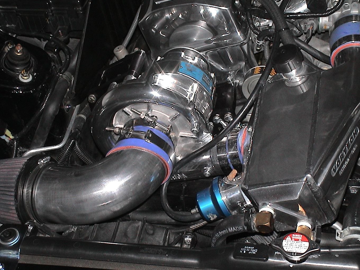

Several of us are running a 4 inch 6061 aluminum elbow with a filter attached for the intake. The Vortech system has some constrictions in it.
The new system looked like this:
The influence of the exhaust needed to be ameliorated so I added a heat shield:
There is a piece that is not visable under the filter deflecting the radiator air flow away from the filter.
I'll be checking the IAT on the dyno tomorrow, 1.5 bar with the hood closed.

looks good. how much of a difference are you expecting?

What changes have you made since you dynoed at 468rwhp?

Are you willing to share where to buy for others to do? I have wanted to do something like this on my Vortech. Looks great and alot nicer than the black plastic junk that came with it!!

Originally Posted by Sideways,Aug 8 2007, 05:17 AM
New baseline.
There were several major changes since the last dyno.
Not just the heatshield?
